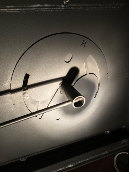

    We had an issue with the IS draft plate being slightly ajar during shipping, but that gave us an uncontrollable fire. The AS is a direct, hard connection to the handle. There is nothing to go wrong mechanically.

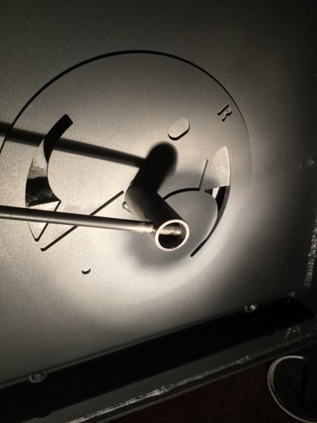

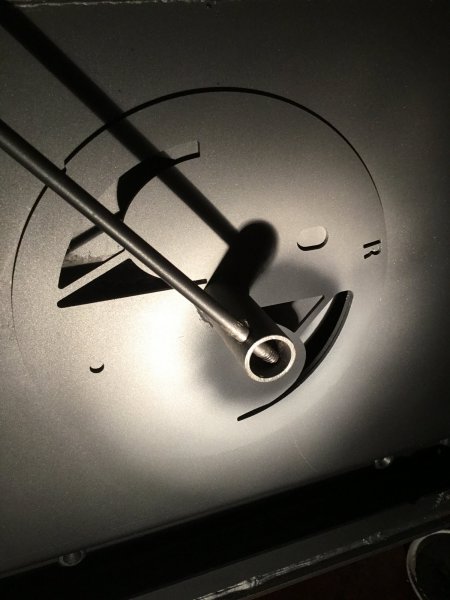

    I don’t seem to have a picture of the AS draft. Picture slightly larger than a dinner plate, with the shaft from the handle running perpendicular through the center of the plate. The plate has two sets of slots (primary and secondary air) that sit over the air inlets. Rotating the plate changes the slots relative to the stove’s fixed inlets.
    Pardon the wet spots, my template came from beside the sink...

    I have seen a similar drawing. That is the reason that I suspect that the connection on the air damper may be a little wrong. Maybe 45* or so out of spec. That is what my initial performance would suggest.

    Here’s a progression from full open to closed. Note the “R”, which is probably a registration mark when welding the shaft to the plate. Also note the handle is a threaded rod. It slides through the first hole in the horizontal pipe-shaft and screws through the second and is finished off with a nut on the end of the rod.

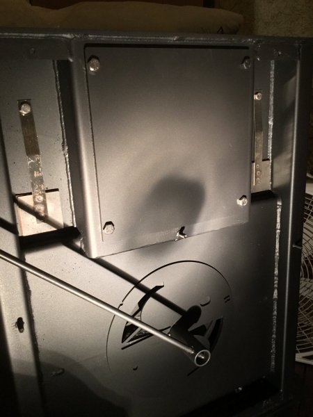

    And here’s the full back, showing the tertiary air supply flappers.
