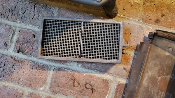

    Since its starting to actually get colder out, I figured it was time to give my stove a tune up last night. I replaced all the gaskets on the AS except the ash pan door, and the top cover. My bypass gasket wasnt sealing at all, so it needed to go, and I figured I would just replace everything else since I was placing an order for it. Once that was all done, I put the new catalyst in too. The stove is back to normal operation this morning. No more cat stalls, or just leaving the bypass open anymore!
