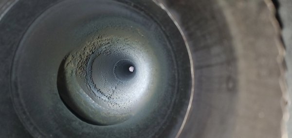

    Your chimney looks good, nice flat brown soot and ash, no creosote which will look black, shiny, glassy, crystally crumble and tar.... It would be bad and dangerous crap to see....
    Here's my chimney after a year of seasoned Lodgepole pine...! 20201020_100431.jpg
