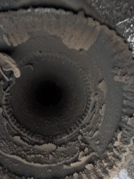

    • On chimneys: And the chimney definitely needs cleaning--I took a picture when I pulled out the cat this morning, and I'm not lighting this stove again until the cleaning gets done! I wasn't sure if a chimney that needs cleaning could cause smoking when the cat is down, but this chimney looks awful:

    9,411
    Your chimney deposits are the desired color. On a brighter note! Report what you find up top with the cap screen (if equipped).

    You cleaned the chimney yet? I may have missed it. Doesn’t look bad, but I see flaking that could have fell down into the top of the stove. Did you also clean the top of the stove? Could be full of crud.

    That chimney is not all that dirty, and what deposits are there are dry and not at all likely to light. Lots and lots of people burning with far dirtier, and far more dangerous chimneys towards the end of a single burning season. Of course there are deposits in there so cleaning it is not a bad idea but it is not anything I would call a pressing issue.
    It also shows that your tenants ran the stove pretty cleanly because a lot of smoldering fires would produce a lot more creosote than that.
    Just my own opinion and experience but a 'bad' chimney is closed down by at least half, and a 'really bad' chimney is completely blocked off.

    Update: we cleaned the chimney today, cleaned the cat once again with distilled water and vinegar, cleaned all the internal workings of the stove that I could reach.
    And now it's burning brilliantly again--no smoke at all once I drop the cat.
    I suspect the chimney cap was the problem--the bottom of the chimney wasn't bad, but as someone suggested, the cap was nasty and closing in with creosote. Now that everything's clean, all is well! Thanks for your suggestions.
