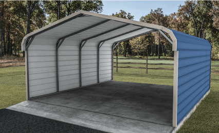

    Well, get to thinking about it...my "metal carport" woodshed has the roof panels running "east/west", still works fine...the water just runs off the end instead of the side of the shed (my shed is not perfectly level)
    Like this...

    How many of those panels do you have? I would build a simple lean to shed type roof, open on all sides for maximum air movement. Accessible from two sides so wood can be easily rotated. Crib the ends. No sun as Backwoods Savage stated. Air flow will dry the wood fine.
    It'll hold about 9 cord stacked 4' high.

    I have 6 and with the overlap, that’s 18’ of coverage. So plenty for a roof. Just would be east/west vs north/south

    This is what I was thinking cut it in half. Run it the correct way. The shorter panels will be lighter to handle and fit better.
    You could fill in with clear polycarbonate panels for light if you don’t have enough metal. You could also install the metal panels from the right and left toward the center having room in center for a couple of the polycarbonate panels in middle.
    The polycarbonate are very strong and will hold up well.
    The only real challenge would be how to handle the overlap of all panels to make it watertight.
    Good luck and have a build thread!
