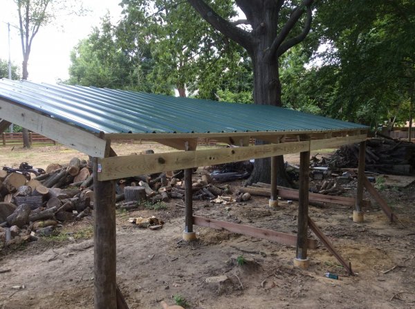

    Got the roof on. Still plenty to do. Didn't really get any overhang but I'm not worried about it. It's better than a tarp and can always be changed. I have $150 in the roof and screws.

    The problem with having no drip overhang of the roofing like that is all the rain water that lands on the roof will now be concentrated at the bottom edge and flow over and saturate the wood support framing. This will accelerate the rotting of that wood framing. It could have been avoided so easily.

    It's all treated lumber. I build fences with the same wood and don't put roofs over it. It will all be painted with fence coat black, asphalt based paint. I'm not worried about it rotting for years.

    314,073
    You can always put up some siding down low to keep the splatter off the wood. Perhaps not the best but it will work if done right.

    The 3 sides get boards and will look just like the fence does behind it, except higher. The rain that can get through isn't a worry to me. We never even top covered our stacks for years. Snow doesn't last months here.
