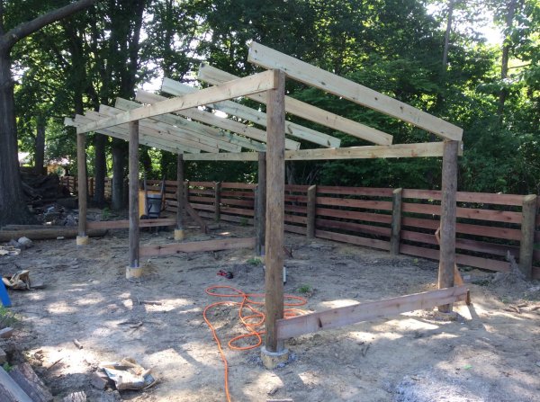

    Made some progress finally. Still have a lot of work ahead. My rafter spacing is about 33" and I'm second guessing not going 24". I think it'll be fine once I get the 2x4's up there and the metal roof. It just looks like a wide span but we don't really get a lot of snow here. I guess if it collapses it won't hurt much but my pride. It's about 90 here today but I've been in the shade all afternoon. Not a bad few hours overall.

    Lookin good right now :thumbs:

  3. papadave
    Nice progress in this heat.
    You might regret not having more overhang, especially on the back side.

    I almost bought 10'-12' 2x6's so I could have an over hang both front and back. I'm not going to panic it. I think I may put the boards I used on the fence up the sides and back. The back would go in brackets so I can lift them out to load and unload from the back also. I agree though, a bigger overhang would be very nice.

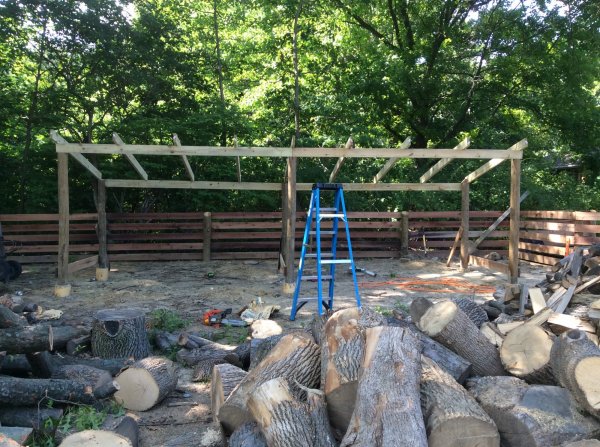

    Coming along nicely! In the last picture, it looks like the wood is anxiously waiting for you to finish.:rofl: :lol:

    Not a worry My friend, I built trusses such like a pole building and there on 4ft centers! Hasn't fell in yet! ;) But I did do the numbers, it's plenty strong for snow load here. I don't think you have to worry with 2x6's up there!:cool: It's looking sweet!

    At this point it would still be pretty easy to sister extensions onto those 2x6s for more overhang...I have 1' of overhang on my shed...not nearly enough. If I was building a new shed I personally would go at least 2' overhang

    Forty, I think the metal roofing needs to be supported by the purlins by an area no bigger than 2' by 4'. Or 8 SF. We put up a deck cover that way and it has held up with our local snow falls. We even used 1 x 4 for the purlins and it has held up. 2 x 4's and you should have no problem.

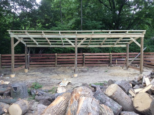

    Made some progress. Added the strong tie hurricane straps, purlins for the roof and some diagonal bracing. More bracing to come, the sides need slatted in 1x6 "fence" boards, steel roof, trim up the purlins and decide on whether to leave the back open or slatted. Homestretch now. I think the roof will go pretty quickly once I go get it.

  18. Lumber-Jack

    For a rear overhang keep in mind that unlike other forms of roofing you can overhang you metal roofing up to about 6" top and bottom with out any problems (providing you don't intent to install eaves-trough).
    Most roof problems I've seen are people not allowing enough of a overhang and the water tracking back under the overhang and getting the wood wet and damaging it.
    Very common with shingle roofs.

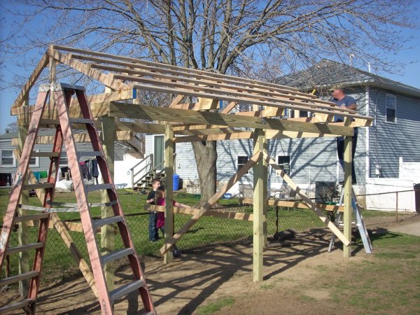

    I built my first woodshe (almost entirely out of salvaged material) but when an expansion or a second one was needed I just bought a steel carshed. Can't buy the material for what it cost to buy and have delivered and built an 18x24. It's $699+tax. Swags and I had the same idea. I have a thread somewhere as well.
