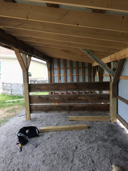

    Partitioning was tricky. I knew I wanted something and knew I should reduce and potential side load on walls. Came up with this:
    5/4 extra decking on both ends (gal nails holding it)
    Extra 2x12s spanning from post to post (had to build out from one post to get the 90).
  3. BuckthornBonnie
    BuckthornBonnie
    997
    3,318
    Penn Yan, NY
    Get a nail bag if you don't have one...
    I used a lot of old fasterners I had from my grandfather's place. Only bought a few structural screws and tin screws.
    Still not done with trim tin, facias, gutter, pressure wash, then paint. Also need to level gravel a bit better.
    But... I did start to fill it today.

    Air can still get in but little drying is needed for me. I'm a few years out so I won't be relying on the shed to season wood. The gravel area behind it will have stacks as well.
    We're going to watch that area for water problems and will curtain drain it if needed.

    That knee brace or "kicker" is just one of those things. On large barns they're installed way up to the trusses--- my thought on a smaller scale is: why not? With pole structures it's sometimes better to think of wall, roof, other walls as separate entities (so to speak). The tin helps.

    I don't have a pic of the post setup. It's the way most dairy farms are built around here if they're not tubes or footers. Basically get the hole below frost code depth (really frost can get down 4-5ft here and other places), them tamp w spud, then place blocking, then tamp w post if you can. Get concrete around it all, brace w rocks and soil, then fill and knock air bubbles w spud bar. Then tamp... may still settle around posts.
    Lots of ways to do this. Some codes dictate other methods and don't like the bagged crete. Ask your code guy what he thinks is best.
