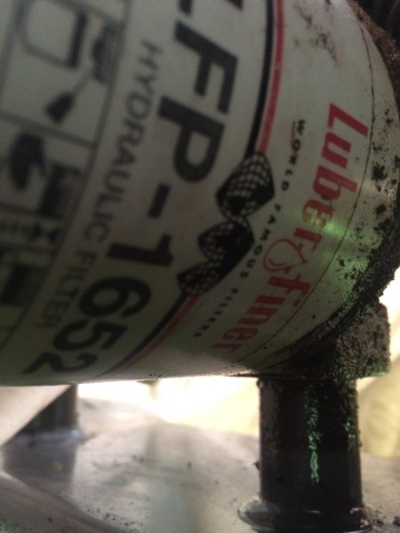

    Does the current filter have a part number on it?

    Yes it does.

    Here's the filter

  16. Butcher
    Butcher
    Oct 3, 2014
    1,071
    7,239
    Thats a standard TSC or Farm fleet filter. If you dont have a TSC in your area any NAPA store can cross reference it and get you 1 and probably cheaper and better quality.

  18. brenndatomu
    25,305
    164,739
    Looks like that crosses to a Wix 51259...or NAPA 1259
  19. 94BULLITT
    94BULLITT
    Sep 20, 2014
    2,446
    7,189
    Frederick County, VA
    I'd go with a Napa Gold which is a wix.
