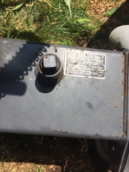

    As far as I can tell there is no dipstick or drain plug for the hydraulic fluid?
  7. HDRock
    17,244
    60,314
  8. NBourque
    NBourque
    Jul 12, 2016
    261
    726
    Maine
    Pardon my ignorance but how do I remove this bolt?

  11. HDRock
    17,244
    60,314
    Screw it out w an adjustable wrench or channel locks shoulden't be real tight

    Check the breather hole in that cap , to be sure it's clear , blow through it or poke some wire through

  14. HDRock
    17,244
    60,314
    This look like yours ?
    brenndatomu likes this.
  15. HDRock
    17,244
    60,314
    Nope, No drain hole
    brenndatomu and Backwoods Savage like this.

    I found that manual online. Mine seems similar but maybe not quite the same. How do u drain the oil?
  17. Nixon
    Nixon
    669
    3,015
    West Sunbury,Pa .
    Pull the lowest hose .
