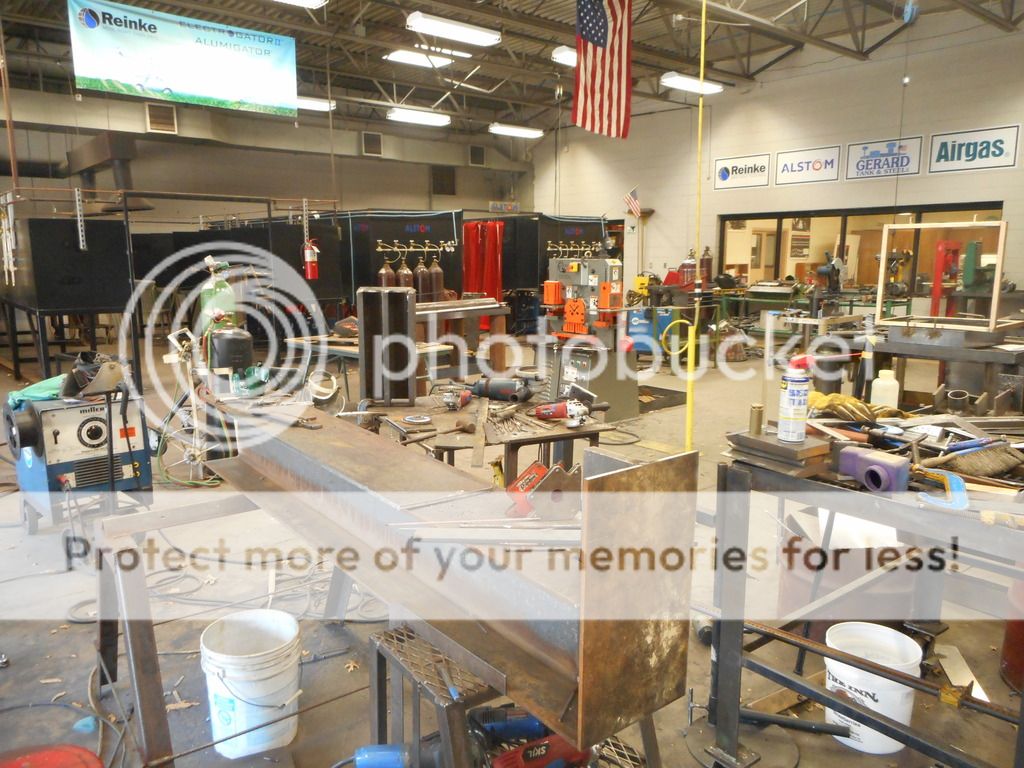

    Here is our shop. One of the best benefits of my job is having control of this playground. Almost all of our real goodies were donated by our local industry. It has made a huge difference in getting kids ready for the real world. It is not unusual to have kids come out of my program and make $20 plus an hour. A couple of my guys did 1 year of tech school for welding. One is working on a pipeline in Wyoming and made $85K last year. (He was very upset about the chunk the tax man took!) The other is pulling down $2800 a week doing plant and refinery turn arounds. They are both 19. I am so happy for them but it makes me wonder what the hell I'm still doing here making $32,000...[​IMG]

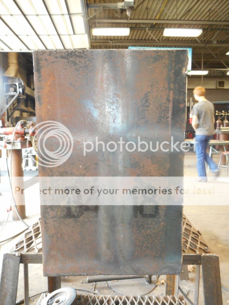

    Here is the wear plate welded down. Under normal circumstances those welds should be wide enough to touch the top edge of the plate. These are smaller so that when the wear plate wears out I can grind them out easier to replace it. [​IMG]

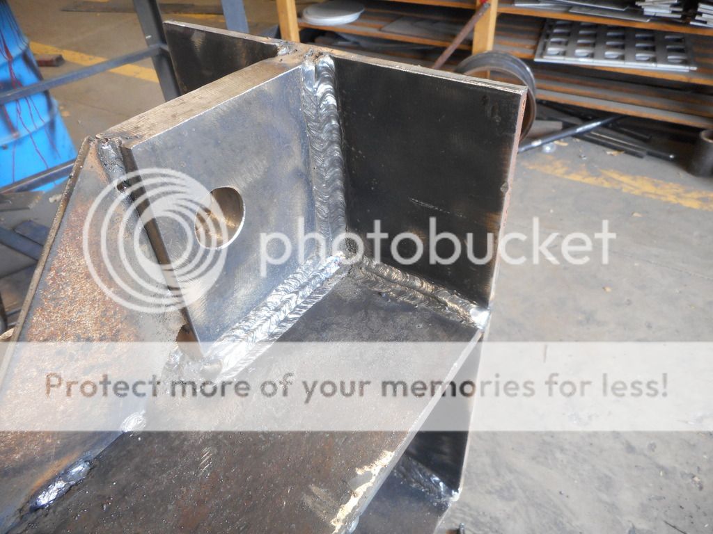

    Here is the anchor point for the cylinder all welded up. You may have caught my mistake. In the first picture I posted of this area I had the hole flipped. What an idiot! I think I just plain got caught up in the excitement and wanted to start welding. It was a good lesson for the kids because they saw that even I could get caught in a jam not paying attention to detail.
    The piece at a 45* angle is just a brace for welding. I am laying my root pass with 8010 rod for maximum penetration, and then filling the rest out with 7018 for strength.[​IMG]

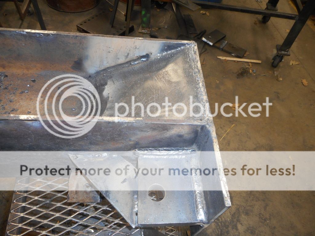

    Here is the back side of the anchor point. I posted this to show the heat signature, or heat lines from the welding. They appear as the blue-gray fuzzy lines. This is a good indicator of strength showing that the heat from the weld has penetrated into the base metal, thus causing fusion.[​IMG]

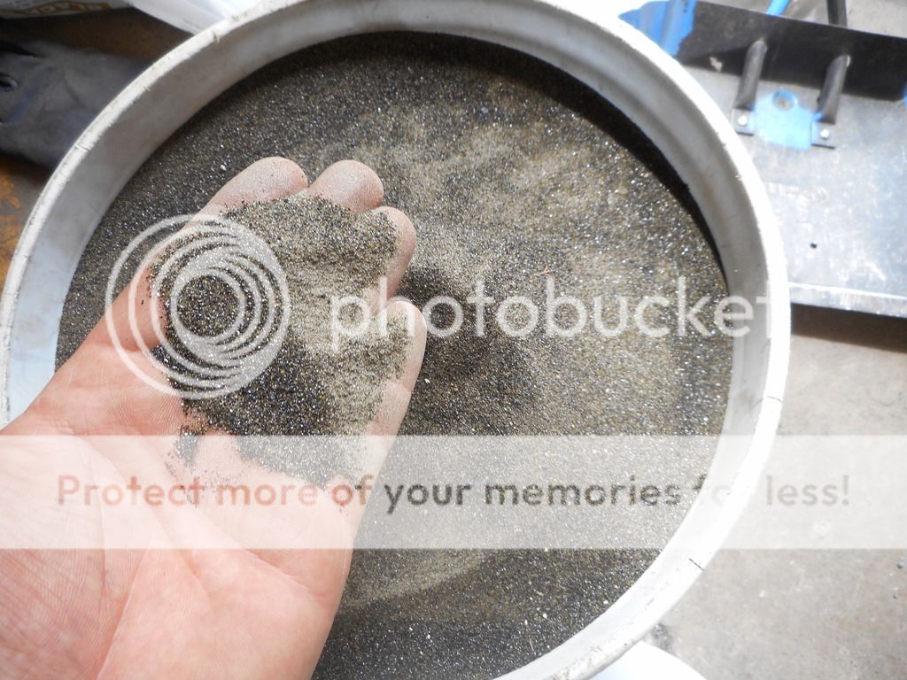

    This is the used abrasive I swept up. Still in good condition and with a little filtering I will use it again.[​IMG]

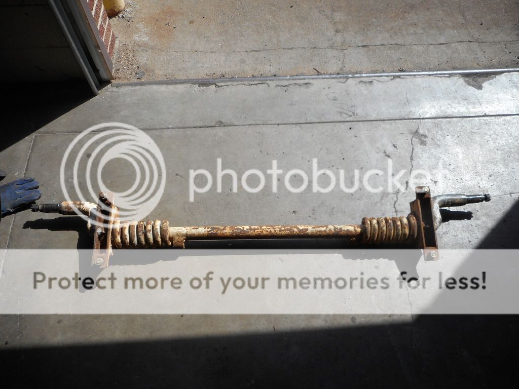

    Here is the before on the axle[​IMG]

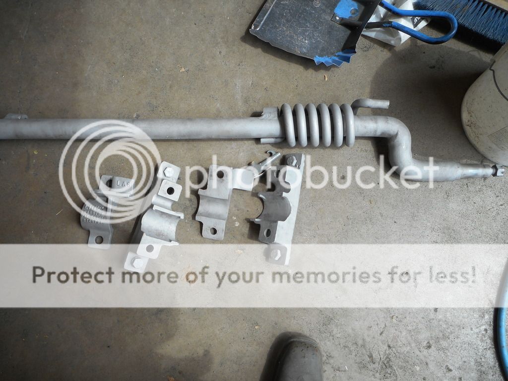

    Here is the after. The abrasive was just right. It cleaned it easy and left a nice slightly rough surface for painting. The blasting place in town quoted me $100 and for $120 plus abrasive I bought the blaster to use again and again. And with all the old crusty stuff I deal with, it will be too soon [​IMG]
