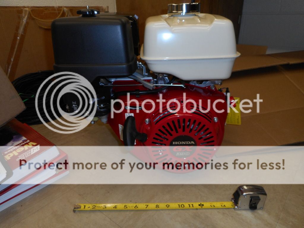

    Here is my motor. A Honda GX 390, 13 hp. I wasn't planning on getting a new motor but to order the individual components I wanted was only $100 cheaper than to buy the logsplitter kit that P&J offers.

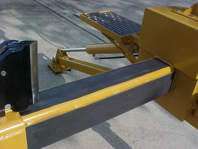

    I would think long and hard about greasing the slide. I have 50+ cord through mine and the paint is barely wore. To my way of thinking grease traps the dirt and it will wear faster. I have never seen a splitter with a greased slide.
    Evanrude, Horkn and Kevin in Ohio like this.
  11. Kevin in Ohio
    Kevin in Ohio
    Oct 15, 2014
    1,067
    6,287
    Agred. I'd suggest some graphite paint to help with any initial galls. Just make sure to round any edges before assembling too as this will help a lot. Your slide is long enough grease is really uneeded.
    Most farm stores or ag equipment dealers have it.
    I painted all four sides of the beam on mine with it.
    Over 100 cord through it here. Top naturally wore off and sides are fine. Not planning on a recoat at this point.
    Evanrude, Fifelaker and Horkn like this.

    Money and time mainly. Those who have ever worked on farm equipment can tell you that most everything doesn't get primer from the factory. It's a tool. The more layers you put on the easier it is to chip. As I said, if I let it sit outside in the elements I might have considered primer but I don't even work in the rain with this one and it's stored under roof when not in use. This was sandblasted and painted in the same day, one VERY LONG day. The next day assembled since I used hardener it was ready to go.
    It's not a show car, it's a tool.
    These pics were taken this morning and it has 3 years on it now.
