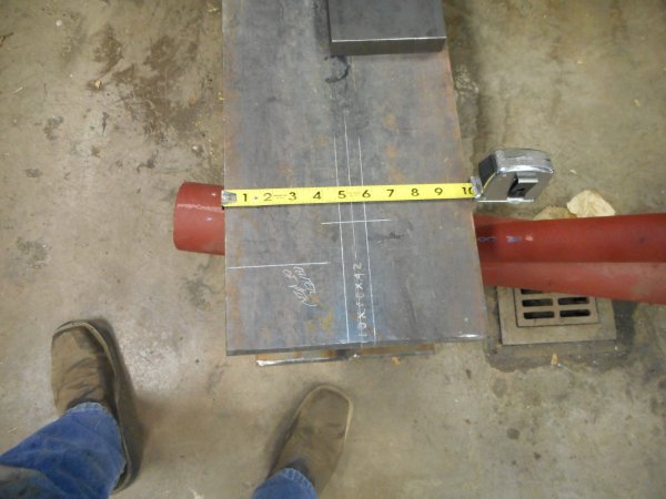

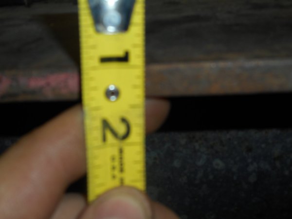

    Here is the beam it's a 10x10x42 with all sections being 7/16" thick

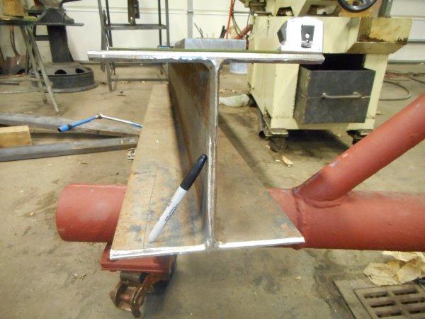

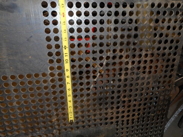

    In the top pic I'm showing the thickness of the beam. The second pic is some material I will try to use as some sort of engine protector

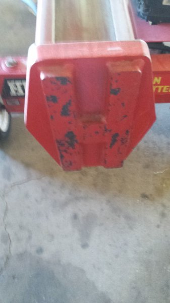

    This one is mine. The cover is 1" thick. You can't see the H. I will get a pic later.

    The foot on a Husky 22 is 1.25 with a .625 H welded on.

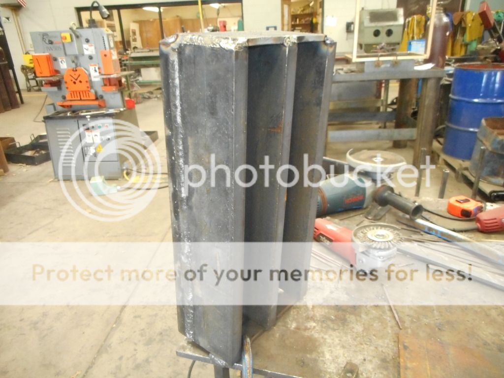

    [​IMG] This is the new foot I've been working on. The front plate is 1" thick and the three reinforcement pieces are 4" wide 1" thick capped on the end with 3/8" plate. If I had to guess I'd say it weighs about 150lbs... Overkill? Maybe

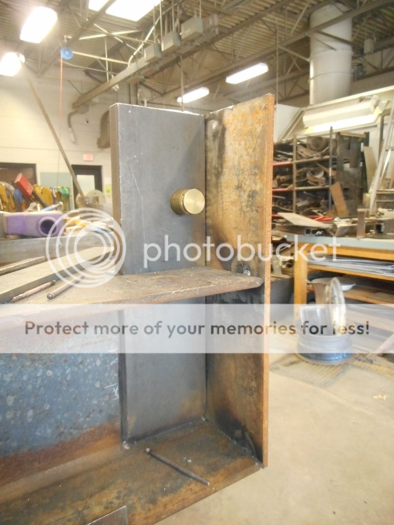

    I decided to set the plate into the beam for maximum strength. I beveled all the joints so that I can insure I get 100% weld penetration. The backing plate is 3/8 plate and ties everything together. I plan on boxing a lot of that in to reduce flex and twisting of the beam.[​IMG]
    I'm not sure what the technical name for this is, but it is the push off point for the end of the hydraulic cylinder. It is 1" thick and the pin is 1 1/4". The picture makes it look like the pin is located almost all the way to the back but there is just shy of 2" from the outside of the pin to the end of the plate. .
