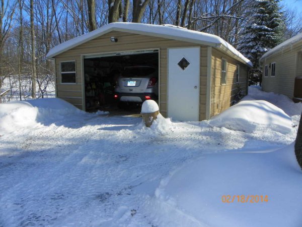

    Another thing you fellows might consider is a carport. The steel carports that are for sale it seem almost everywhere. I've seen a few and they work out really nice. Swags put one up last year so you could look up his thread where he loaded it.
    In our case, we considered putting up a carport for our car and then stacking wood around on the 3 sides. In the end we did not do that but still may. What we did was to buy a carport but also added sides, windows, walk-in door and 2 overhead doors. We stack 2 1/2 or up to 3 cord of wood in it during October and usually by the end of burning season it is all gone so we have that space to use in the summer months.
    Here are pictures of the wood inside and both ends of the carport/barn.

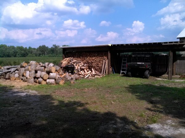

    Here's a wide shot of mine. The uprights are powerpoles buried 3ft deep, the cross beams are cull 2x12's i got from a lumber yard and the roof is made of 5x10 skids with a billboard tarp on top for waterproofing. Each section is roughly 9x16 inside the poles. It aint pretty but it get's the job done. :cool: Not to mention it's gonna take a bulldozer to take the dang thing down.

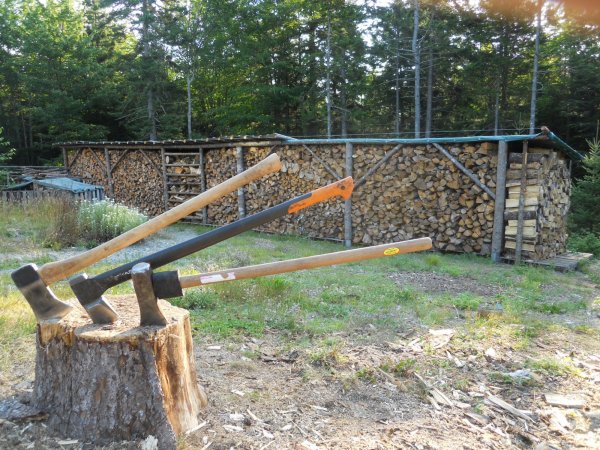

    10x50 about 20 cords
    I'm not much of a carpenter, so I figured there wasn't much point in starting with nice straight and square lumber, cause the shed wasn't going to end up either straight or square.:)
    I had a supervisor too
    An uglies bin in the middle
    Here's the roof going on
    The roof is not finished yet.

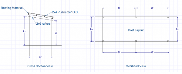

    Here is a little shed I drew up for someone on another forum... can be adjusted to different sizes.... this is what I do for a living.
  18. papadave
    Basically what I did, except it's 10' deep and no purlins. I did OSB and shingles. Pretty much the only differences.
    Oh, and mine has a 1' overhang front and back.
