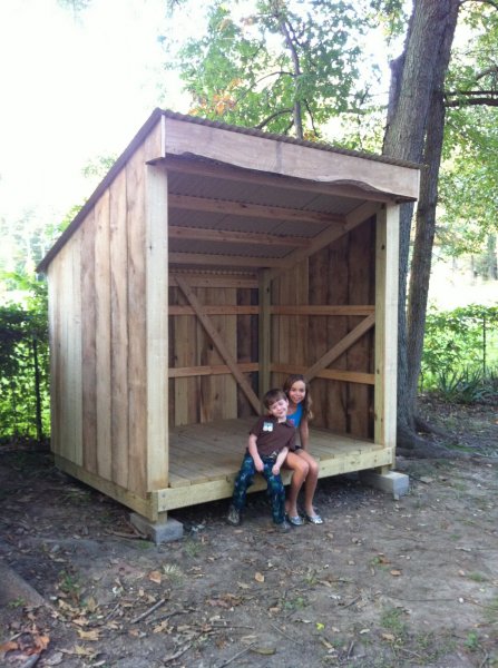

    DrewCat, that's a really nice shed!
    My main shed only holds 1 cord, and I have a second small shed for about another 1/2 cord. I refilled both a few weeks ago... Wish I had a 3 cord shed. I could build one easy enough, but I just have no space for it....

    That is a nice shed! I may have to make one of those out of the first boards I mill. That is if my deal for a 394xp works out tomorrow.

    Thanks Machria and cryzbowhntr on the shed compliments. I built that this past fall with wood off my mill, love being able to use my own lumber. I cringe at the pictures I see of some of the logs on this site that are turned into firewood (I don' hold it against anybody, just envious)!

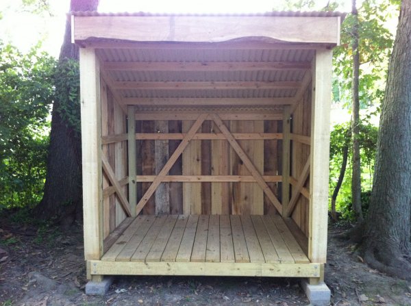

    Bit of a thread hi-jack, sorry tfdchief, but here are some other pics of the shed.

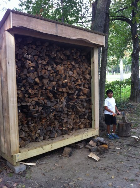

    All filled up.

    Yes, the end joists are treated 2x6's from the lumber yard but the joists underneath (16" centers) are dimensional elm 2x6's. Seems to have held the weight just fine, its only an 8 foot span.

    The money shot. I see a Fiskers.
