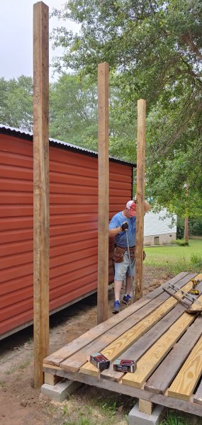

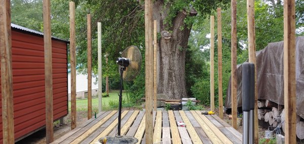

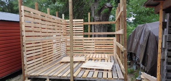

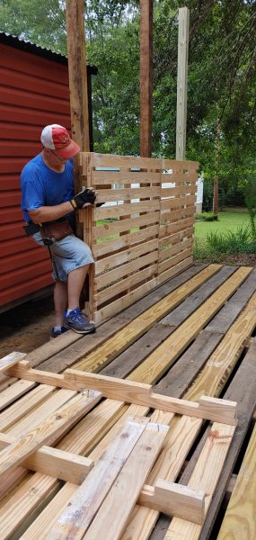

    All 12 post are set 0608201109a.jpg Checking the fit of the pallets. This is when I discovered I had to take the back boards off so the pallet would fit tight on the 2x6's. 0608201150_HDR.jpg Got the first wall started with 2 pallets hung. 0608201234_HDR.jpg Hope to do so more in the morning

    Got a lot done by myself today, I was unsupervised...lol...ran out of screws and thunderstorm popped up. It has 8' walls. 0609201618.jpg

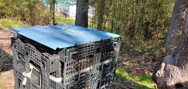

    Throw away pallets. Our plant processes Kaolin clay, which is then bagged in 50 lb and 25 kg paper bags, the paper bag company ships us the bags on those pallets. Our bulk bags (750-2205lbs) come on the plastic pallets that I build bins from. 0118201234.jpg 0120201223_HDR.jpg

    T.Jeff Veal How do you fasten the pallets to the uprights? Do you go thru the pallet into the upright or the other way around?
  13. T.Jeff Veal
    29,683
    190,441
    I fasten 2 2x6's to the 4x4 uprights, spaced to fit in the notches on the pallets. Then drive screw thru pallet runner into 2x6. These pallets were soft pine, 2x6 was harder. If pallets are hardwood, I would drive screw from 2x6 into pallet. If you look at the right hand side of the shed, you can see the 2x6's screwed to the 4x4's.
