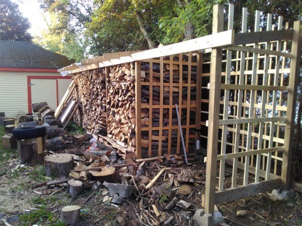

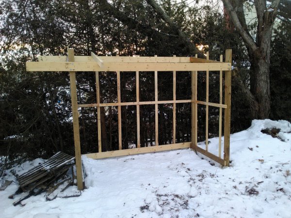

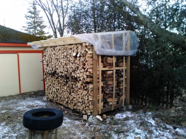

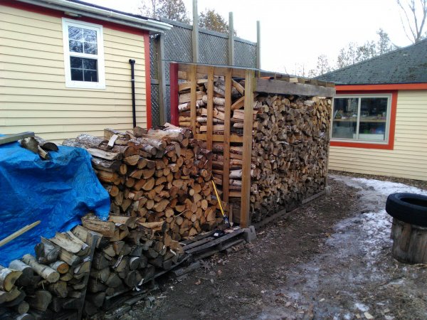

    Just some pics of the evolution of my woodsheds. I tried to keep the cost down as much as possible (see vapor barrier roof!) and yes I know it will disintegrate but it was still cheaper than real roofing and I had it spare. The location is the only one available to me, lots of wind, not a lot of sun.
    Lessons Learned:
    Raise pallets off the ground so they remain solid and don't rot.
    Ensure the wood is angled toward the back wall of the shed. First layer is tilted back.
    A pickaroon, tire on a chopping block, Fiskars X27 and an audiobook are essential
    Don't pizz off the neighbor with water runoff onto their driveway! (note angled roof direction)
    If space is limited do your research about what wood to take or scrounge, not all wood is created equal.
    This process happened slowly over the course of about two years with the help of my now 4yr old. It was just wonderful having her there "helping" me. She now knows about drills, levels, pencil sharpening, measuring tapes, chisels and ladders!
