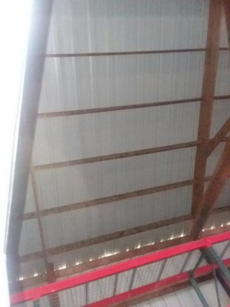

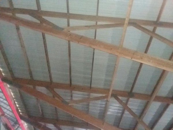

    My cutting buddy sent me this...
    Inside of a pole shed they are renting for work. 8' center to center and 2' between purlins. Resized_20200807_092922.jpeg Resized_20200807_092816.jpeg
    Seems kinda wimpy.

  17. brenndatomu
    25,311
    164,786
    Sounds like one of those sheds you see advertised in the back of the farm and car trader magazines... national company that comes in and just builds to a price point...
