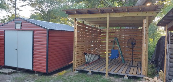

    The shed floor 11'4" to the 4x4 post. Since I had 16' 1x4 stripping, I made the roof 5 panels wide, so it about 15'1" wide. I think it has 16-18" overhang, helps with elements (rain/snow) blow in

    Lol. My roof line is different. The overhang the long way on mine had to go over the lower Bay's. That's why it would look weird.;)

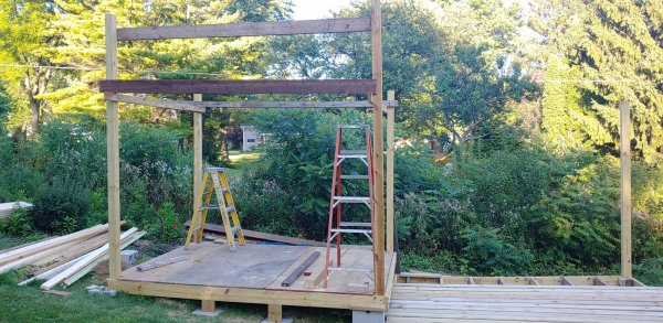

    The left bay is decked, all set to move to the roof. I threw up the braces. That cedar up to is not fastened, just to see what it looks like. I'll be using 2x6 all the way around at the top. The 2x4 in back was just to shore it up. So what's the take on screwing the roof fasteners ( proper self tapping rubber gasketed machine screws) into the ( 18" spaced) 2x6 roof joists and have 2x4 purlins underneath the joists, or space the 2x6 joists at 24", then run 2x4 purlins on top of the joists and screw the steel roofing into the 2x4 purlins?
    I'm waiting for the roofing to arrive, and will have the middle bay decked shortly, and the right bay I need to do the outer deck blocking. The way things are rolling, timing should be good with the roofing arriving maybe when I just get done with the roof structure.

    I would use 2x4 purlins, it will give you more flexibility, you won't have to worry about fasteners and deck ribs being located exactly over a joist. In other words, 2x4 purlin over joists at 24 c/c

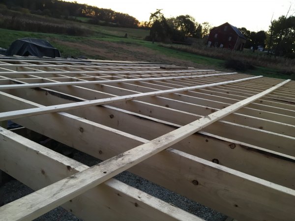

  18. T.Jeff Veal
    29,753
    191,075
