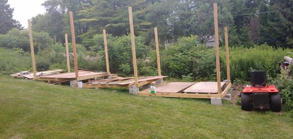

  11. Horkn
    29,240
    166,925
    All of my threads are derailments. :rofl: :lol:
    Ok. Sammiching the 2x4's together with construction adhesive and screws.
    Got 1 done so far. It's really strong now. There's 3 cement/ block pilings under each center span.

    Speaking of which..
    I got the center supports almost all done. They are mega strong. Just gotta get those outer mid supports on. I've found that a car jack works great to lift each deck piece up a little bit to allow the boards to be tight when I let it down.
    I used a sealer on the plywood. That seemed to help. Eventually I'll use deck boards on the outer two bays like the center bay will be. Now not the time with shortages on the deck boards.
    I plan on working on it tomorrow until the rain arrives. The wife will go with me to Menards to pick out the color of the metal roofing. Then it will be about 2 weeks for that to arrive. By then, I should have the freaking for the roof done.
    Getting there.

  19. Horkn
    29,240
    166,925
    Ok got some work on the shed done before the rain hit. Tomorrow evening I'll work on those outside supports. Then I can screw the floors down. After that, it's onto roof rafters or whatever you want to call them. I'll do the boards for the sides after the roof is up. That way I can have some shade.
