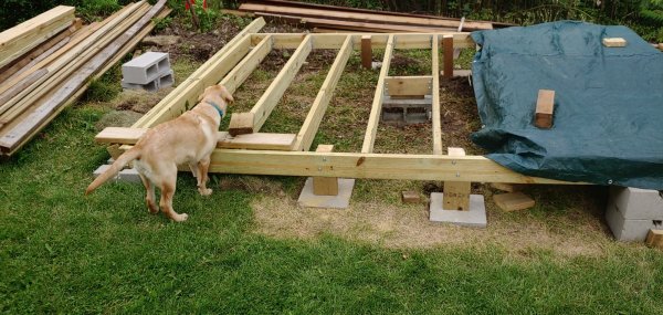

    Skip the fasteners on the center supports and block it up. Even lag bolts aren't enough.
  3. Horkn
    29,246
    166,964
    Ok, I'll add blocks directly under the joists. I've got enough scraps to do this.

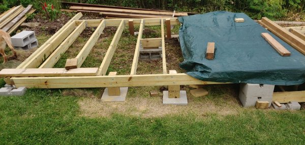

    Ok, done for this evening. All blocked up. At least the first bay.

    This one has a better picture of Hayden. Yeah, he's getting huge.
