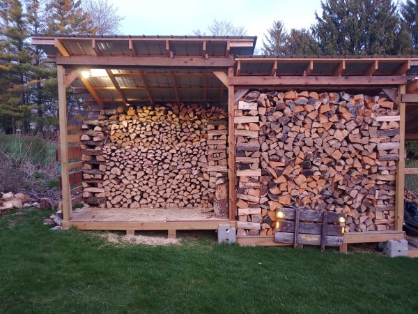

    You wound up building a VERY nice shed.

    Be sure to check the treatment rating on 2x4's, most aren't ground contact treated.

    All good things to learn. Thanks everyone. I will be sure to throw up some pics when it is built. As for the treatment rating, I plan on adding an additional wood preservative to give it more protection for whatever is buried and a few inches above ground. I'd rather spend a bit extra up front and not have to worry about it for a long time.

    T my reference to "a foot" meant like horkin said, a hunk of something that won't rot on the bottom (in the hole) of your vertical and soon to be weight bearing posts. It's not as critical if you don't build a floor and the posts are only supporting the roof, but it's a very cheap and simple improvement over just the post 10.5" (2- 2x4s) or 12.25" (4x4) square inches of "footprint".

    I'm very happy with it. The arborist was super impressed with it.
    He'll be out next Friday for dropping the ash trees. It will get more full soon.
    Also theres about 2 trailers full of branch wood from ash trimming at my buddy's gf's house. I'll probably get that branch wood this weekend should be a lot of 1 split firewood, which is just fine with me.
