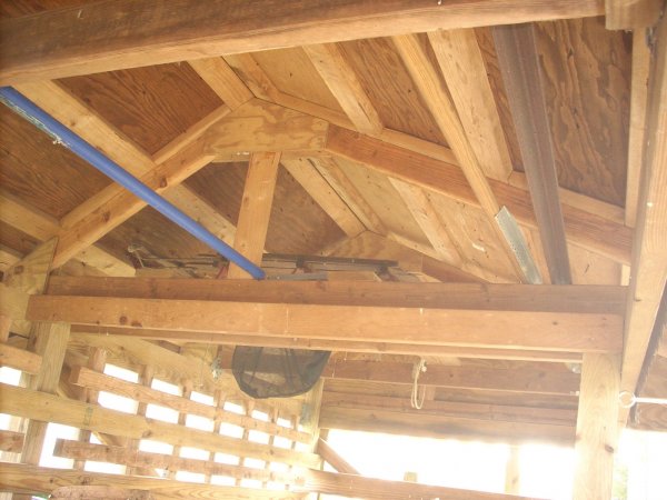

    First off, Welcome T. Harris ! Nice to have you with us! :handshake: My wood shed is close to your specs, 16'L x 7'D x 7'H. I'll dig out some pics and post them for you. I made a simple truss for the roof and it went real easy. :yes:

    It was faster to just snap a couple pics. It's been there since Apr. 2014 Here's mine and packed "correctly" it'll hold just at 4 cord. :whistle: It's normally what I'll burn a winter. It doubles as a clothes line also! :rofl: :lol: I have to 4x4's with a little table 25ft out from it.
    Because I'm in a sandy soil area, my posts are down 3ft, packed in 12" diameter of cement and a 4" footer, I am in a direct hurricane area also! It's already withstood several gust's at 90+mph and 1 at 104mph. The rest is self explanitory.
    I season my wood 3 years "uncovered" because the summers can be scorching after 2 years, I put the seasoned wood in the shed for the winter.

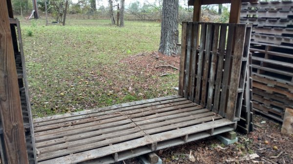

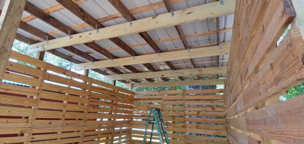

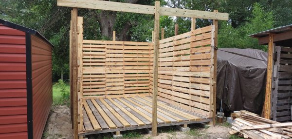

    Welcome to the club. Lots of great folks here sharing knowledge and humor. We have built several styles of sheds, using wood pallets, just keep them off the ground. 0619201322.jpg 0703201244_HDR.jpg 0705200737.jpg IMG_20191107_093117989_HDR.jpg IMG_20191106_103518478.jpg 0306201724.jpg

    Pallets are "Awesome" and sadly I have unlimited access to "wood" pallets if I wanted, our local military base usually destroys about 1000 a year because the suppliers don't come back for them. I can't use wood on our ground here. :headbang: :picard: Those little B@$tards called Termites have some SERIOUS appetites o_O... You have some great sheds there T! :yes:
