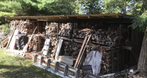

    Wood was stored at first in shed above but tractor and tools took over
    Current wood is stored in other sheds below
    First one I just finished this year and loaded with 3 year old wood for next year. It's 12 ft deep and 36 ft long. Built with pallet racking frames and beams.

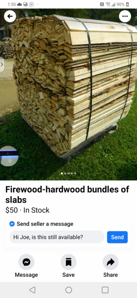

  5. brenndatomu
    25,305
    164,732
    Bundles of slab wood...those can still be had for $15-20 around here...rifle through and pick out the "siding" looking pieces, those go on the shed, the rest goes in the shed :)

  7. brenndatomu
    25,305
    164,732
    Yeah...but his price! :faint:
    And those slabs are thinner than I am used to seeing...heck the ones we have gotten usually have a few pieces in that need split!
    My sister ordered a whole semi load of them last year...I think they could only fit 8-9 bundles on the trailer...was something like $300 delivered...it made a pretty good pile of hardwood firewood too!

    This looks even better
  9. Horkn
    29,240
    166,928
    I know, that price compared to what you said was bad. The screenshot I just attached was better, but 4 or 5' only. I can deal with that by adding a 2x4 in the middle of each side. I've probably got enough boards for the inner walls, but I'm looking for something to make it all look uniform from the outside. Slabs like that would do it

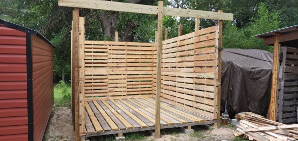

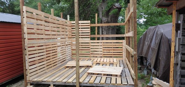

    191,258
    Can you get pallets? I used pallets for our walls on the 2 biggest sheds we built. 0619201322.jpg

    166,928
    I could. That's just a lot of work. Disassembling pallets. Plus they are only 40" long.
  16. T.Jeff Veal
    29,771
    191,258
    I didn't take them apart. Each pallet is screwed to the horizontal 2x6. 0609201618.jpg
