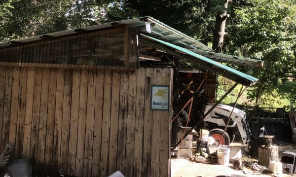

    I see that. I wonder if there's been sagging issues from lack of support in the middle of each bay
    My shed is also bigger as his only hold 9 total cords, and when done will be better roofed.
    They've got a bigger tractor though, and it has a FEL on it.
  8. brenndatomu
    25,302
    164,722
    I haven't had an eye exam lately, but it looks to me like those are larger 2X's than yours (2x8, 2x10?), and shorter, but I think I still see a little sag, especially on the left bay...

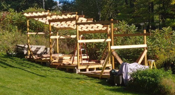

    I was able to get a good hour and a half of work on the shed this evening in between rain showers. My buddy had to swing by and I'll take whatever time he can give to help.
    We got the right Bay's 4x4's straightened, and braced. Then I ripped a 2x12 in half the long way to make roof support beams. We put those beams up, replicating the roof from the left and center bays so they all look the same.
    I'll see if I can get a pic tonight, otherwise I'll get a picture tomorrow.
    It was kind of putzy work, but it was important to take the time to get it to look congruent.
    My buddy will come over again on Saturday, so I'm thinking/ hoping we can get it all finished, at least the roof on by then. Any siding/ walls I can do on my own. I'll probably start getting roof joists measured, marked and cut tomorrow.

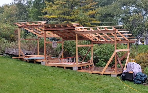

    Ok. Didn't quite get as much as I wanted to get done today for a couple of reasons, the number 1 reason being the drizzle that led to steady rain by 4 pm. The off and on drizzle was not forecasted by any of the 3 local TV stations. The rain by 4 was though.
    Despite the rain, and other delays, we got a lot done.
    Here's where we ended up.
    We put up the 3 of the 4 steel roof panels on the center Bay to have a dry area to work, especially needed for the chop saw with the rain.
    Should be about 1.5 hrs of work left to get the rest of the roof on. My buddy will be able to stop one day after work some day when it's not raining. It's not supposed to rain this whole upcoming week.
    I'll have a bit of work to do on my own before he can stop by though. Mostly putting up the "Tee's" on the ends of the purlins on the right bay and adding the 2x4 tie in's between the roof joists and the roof beams. Those 2x4 tie in's really work great to strengthen the structure.

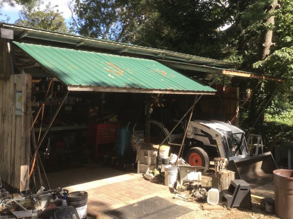

    You might want to consider an adjustable awning on the fronts of the sheds. Would push rain and snow out further and you could park splitter under one to keep it out of weather while using it.
    Some pics of awnings. Also a cheap harbor freight solar light on shed is great. I have one with light underneath out of weather with solar panel out in sun great for nights. Automatically goes on when you approach shed.
