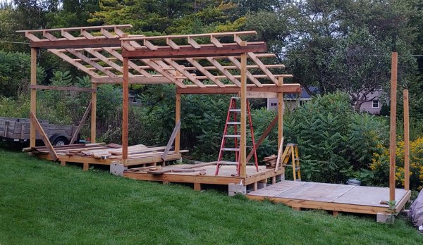

    Had to correct some twisted 4x4 beams, then account for some slightly off squareness. But this is what we got done today. 20200907_185206_HDR(1).jpg
    Having my buddy over really helped, there was a lot of thinking needed as this isn't from set plans.
    The second and third bay should go even smoother, but I've got a lot of odds and ends to take care of before that happens.

    Mass
    I always preferred the diamond style hurricane ties as well. They grab both sides of the rafter. They also make special truss screws that you can drive at an angle through the two top plates into the underside of the rafter, which negate the need for a tie.

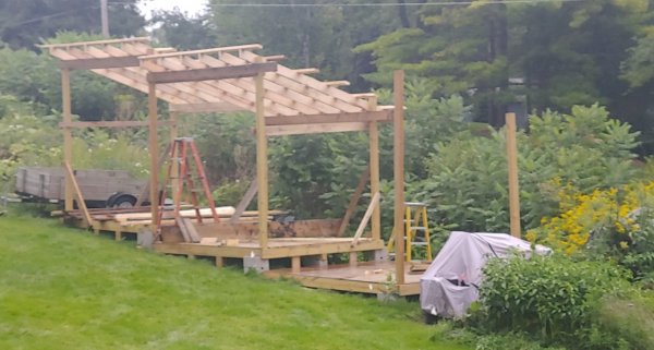

    Yeah, with the steel roofing, any snow/ ice should fly off the back side pretty well.
    Getting there...

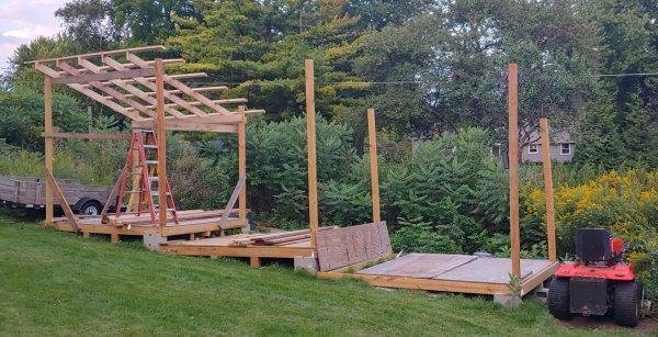

    Got the 4 intermediate floor supports on the right bay, also boxed in the right bay 4x4 uprights, screwed all the deck boards on the right bay down, and put in more framing nails on the roof beams for the center and left bays.
    Next I need to level the far right two 4x4 uprights and brace them, then rip the 2x12 into 2 2x6's so I can mount those up for the roof beams on the right bay.
    I used up all my framing nails and 2.75" screws so I'll need more of both, along with 3) 2x4x12' and a couple 2x6's for the roof joists. It's coming along nicely.
    Then the steel roofing can go up. After that, corner bracing at the tops, and the boards for the sides can go up as well as the two dividing walls between the side and center bays.

    Looking good brother, making nice progress. A small suggestion...if you can get those braces on, it will make it more stable putting the roof on. Walls, even better
