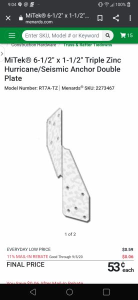

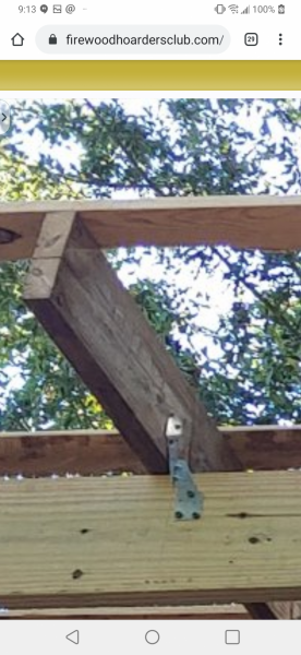

  9. Horkn
    29,249
    167,001
    These ties, do you nail or screw them in? In thinking 10d nails just like the floor joist hangers.
    T.Jeff Veal it looks like nails in yours. Right?
  10. T.Jeff Veal
    29,799
    191,442
    I started out using 1 5/8" screws, but started using some nails too, made the screws go farther. I put 1 screw in each leg to hold in place, then finish with 2 nails each leg.

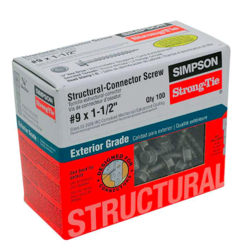

  18. brenndatomu
    25,311
    164,786
    Screwloose, Chaz, mat60 and 5 others like this.
  19. billb3
    10,513
    54,567
    or the proper nail and screw for the size plate you are using
    as mentioned above you want screws with the proper shear strength and these have a built in washer to help spread the load.
    The screws come in different sizes to match the size plate you are using.
    And, yeah, it's a shed.
