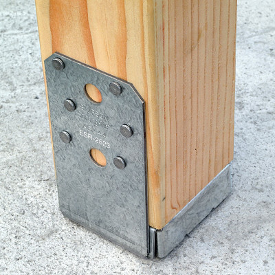

    I'm not a fan of setting modern day treated lumber in concrete or dirt.. How about using a metal bracket system on top of your poured concrete ? bore a hole as required by code, some rock in the bottom, set in a sonotube, pour in you concrete, put in an anchor bolt before it sets up.... When it's cured, add his to hold your post...

    That stuff is slick for setting fence posts - Not rated for top supported structures.
    I agree on mounting the wood above grade - the anchor you posted is not rated for roof supported structures rather deck posts that see almost entirely vertical loads.
    Standof post bases rated for structures get expensive pretty quick.

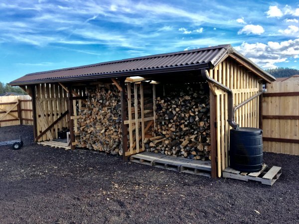

    Good looking wood crib!
