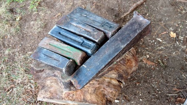

    Get thee some splitting wedges posthaste, and a 6 or 8 pound sledgehammer, if you don't already have one. Steel wedges are easy to find online, Walmart even has them. You need at least three, ideally a small, medium, and large, of the classic straight variety. I split only with wedges, never a maul, and I can split huge rounds without much trouble. If you study the checks and the grain of a particular round, you can strategize your attack. These are my wedges, mostly estate-sale and flea market finds. IMG_20170906_48194.jpg

    Nice looking wood, Kimberly. I agree with the others on the noodling advice, if that don't work for ya, use sledge and wedges......

    I know that Dad had some metal wedges that he used for splitting but I don't recall a sledge hammer; that might have gotten lost as well. I was going to head to the Fleamarket this year but I had just got the car repaired and fuel prices went up due to Harvey.
    What about these wedges? Are they good or a gimmick?

    I prefer the flat wedges over those 4-way. Like using a saw, you'll get better hitting the wedge with practise

    I never tried the diamond shaped wedges, didn't want to buy something I didn't like. Hitting the wedge isn't hard, and if you miss, it's no big deal. I tend to choke up on the sledge handle, and that gives me more control.
