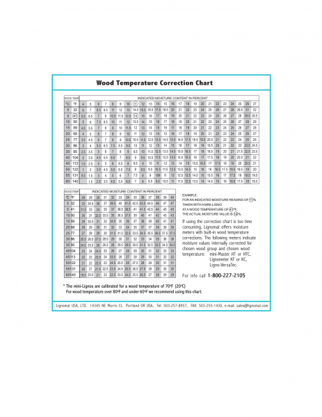

    I did not know or read about the 70°F calibration though. Will keep that in mind. Do you know if it reads higher or lower with increased temps or decreased temps accordingly?

    Hi Chaz, my experience has been that it will show a lower percentage reading when the wood is cold.

    A chart for ya :)
    Chaz likes this.
