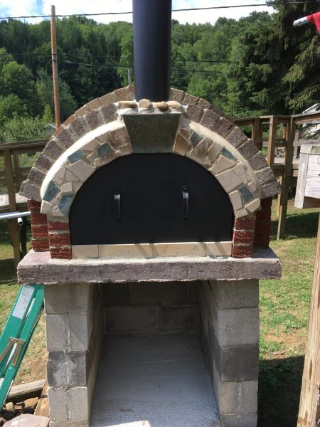

    I have to ask you about the step ladder. Is the oven elevated up to a deck?
    What did you clad the outside with? My buddy is looking for ideas.

    The step ladder was there because I just finished acid bathing it and the the oven is raised up some building a patio to the oven

    The clad I used was 3 parts fine sand 1 part fire clay 1 part Portland and 1 part lime.
