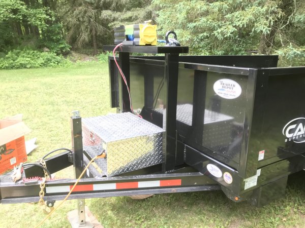

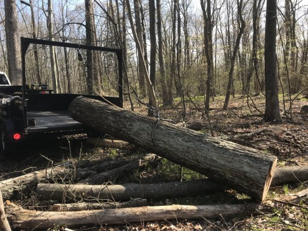

    First pic is winch and frame. There’s a beefy subframe I built under there that runs back to a main cross beam. Thing doesn’t flex more than an 1/8”. In retrospect it should be higher to allow the rope clearance on the logs.

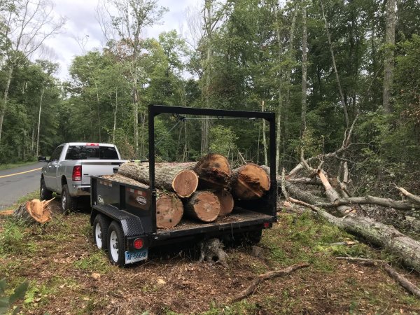

    The back bar is fixed with three picking points. The side posts are 1/8” thick tubing. The top piece is 1/4” 3x3”. Originally had the same light weight as a cross beam but one careless moment bent it so I did a rebuild.
    I intentionally wanted some weakness built into it. Wanted that bar system to fail before it tore the trailer in two :) All in all I’m still surprised how well the trailer and bar have held up. Trailer pockets were reinforced as well as under the bed in the pocket area. It’s a pretty tuff trailer.

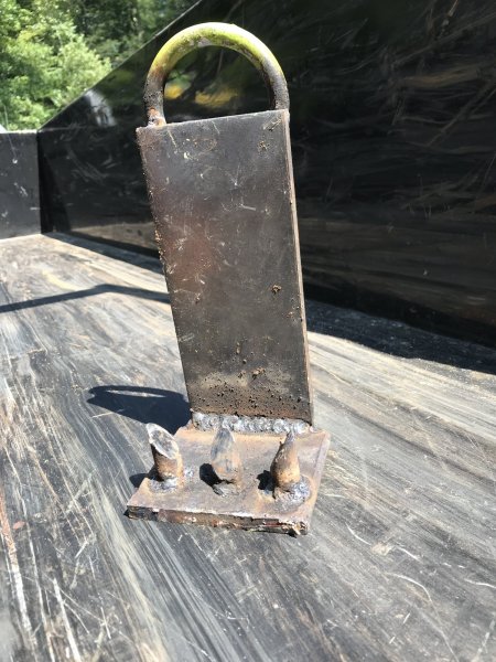

    I’ve since cut the third spike off. Didn’t need it, grips better with two. Yes I suck at welding but none of my welds have broken yet. :)
