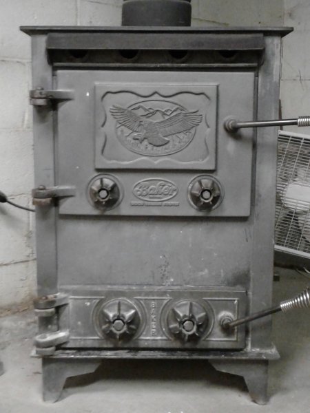

    For 8-9 years I used a Baker wood/coal stove. I bought some coal to try out, for schlitds and giggles. I found it needed much more air than wood. If I closed down my air intakes, it would stall pretty quick. Since it isn't free, I stayed w/ wood.

    Are you saying the coal needed more air than wood in that Baker wood/coal stove? Which model specifically? Did it have shaker grates in the stove?

  15. The Wood Wolverine
    18,860
    121,452
    Yep.

  18. The Wood Wolverine
    18,860
    121,452
    Not sure I burned enough to really learn it. But the door had two vents as did the ash pan door.
  19. brenndatomu
    25,140
    163,365
    Yup, typical wood/coal stove setup...for burning coal the majority of the air needs to come in from the bottom, then the top air is almost closed...just open enough to allow any remaining gasses to burn off...the burn rate is controlled by the bottom knobs...you can burn wood with bottom air too...but you will go through a TON of it! Wood does better with only top air (unless maybe you want to burn off some coals)
