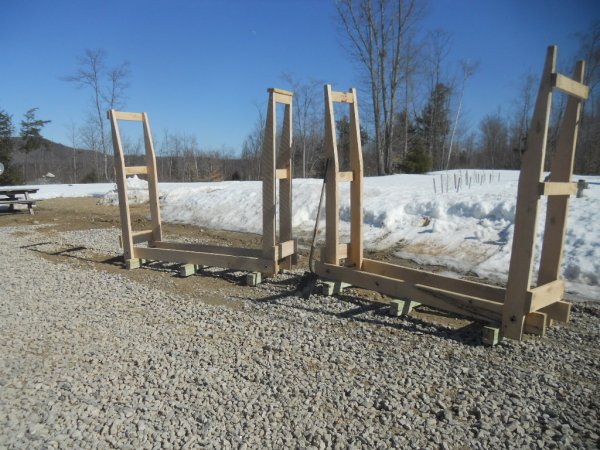

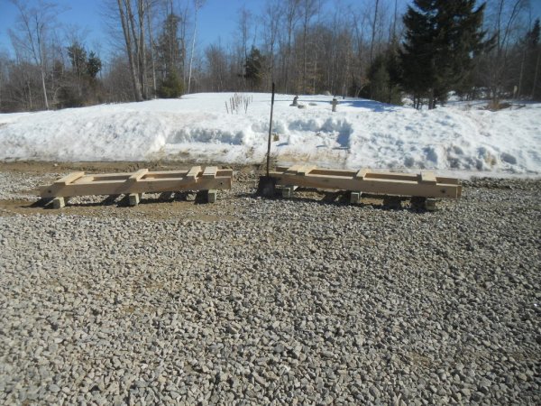

    Thanks for that link Flamestead! Here's my version of it. Very cheap and simple to build.
    2 2x6x10 - 2 2x6x12 - 3 2x4x8 (pt) & some const. adhesive & screws.
    They hold 6' x 6'9" x my 26" cut length that gives me about 70 cu/ft per rack. Now I need to fill them and see how stable they are.

    It looks like you really went overboard on building those racks. They are very nice but I just can't imagine me taking the effort to taper the top part of the ends like that unless it let me make 2 ends from a single board.

    Bingo! 2- 81" pieces out of a 144" board:D

    Looks great - I'll be interested to hear how they handle when full.

    Those look GREAT fuelrod :thumbs::yes::)
    Super sturdy!

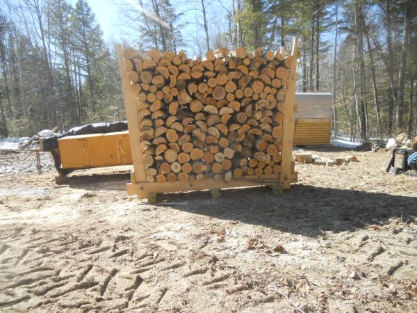

    Not yet, spent a few hours in the woods yesterday with the winch dropping & hauling some Beech. Pretty much sucked, while the snow will support me & a saw, it won't support the tractor. Then (with the deep snow) the tree you just dropped so the butt end is facing out has the stump directly in the way and is mostly burried in the snow and won't roll with a peavy.
    Snow's too hard and I'm too lazy to shovel out enough room for a saw at ground level to cut it. That's OK, the weatherman is calling for 1'-2' "with more locally" for Tuesday into Wed.:whistle:

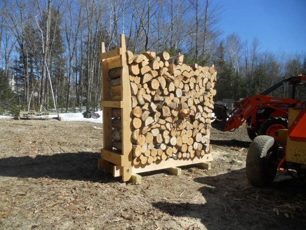

  16. thewoodlands

    Flamestead's version will fit about 70 cu/ft (cutting @26"), add your typical hardwood weight per c/f. It's the end of summer and those facts left my memory a few months ago :rofl: :lol:.
    The first version "crates" need a pretty heavy machine, that SS's 'roc' (50% of tipping load) is 3750#. My longer 26" split length makes a typical pallet or "tote" impractical, but I like to fill the boilers firebox front to back. DSCN8687.JPG
    These are pretty stable and cheap to build, fold down to a small pkg. and is what I think I'll be building. (Flamestead's version)

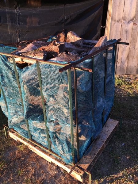

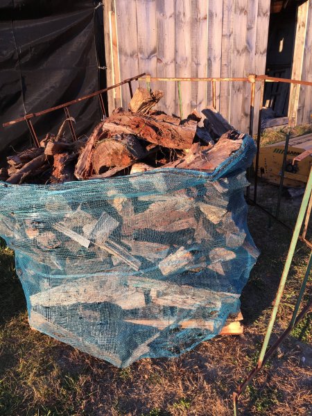

    IMG_2035.JPG IMG_2036.JPG IMG_2037.JPG My wife's place of work was running a processor during mud season for a few years, and one things they tried was dropping split wood into a mesh bag on a pallet. They aren't selling firewood any more, and I have their setup to play with. I tried a pallet of uglies, and was surprised it held together for a couple hundred yards to the neighbors house for their fire pit after I removed the frame. I'm not sure the mesh would survive the sunlight over 3 years of drying.
