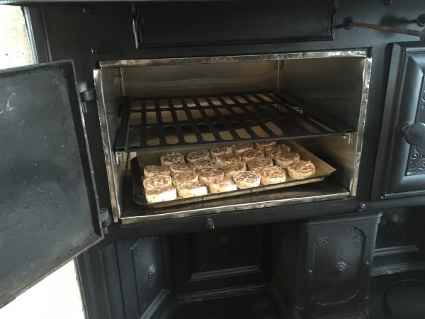

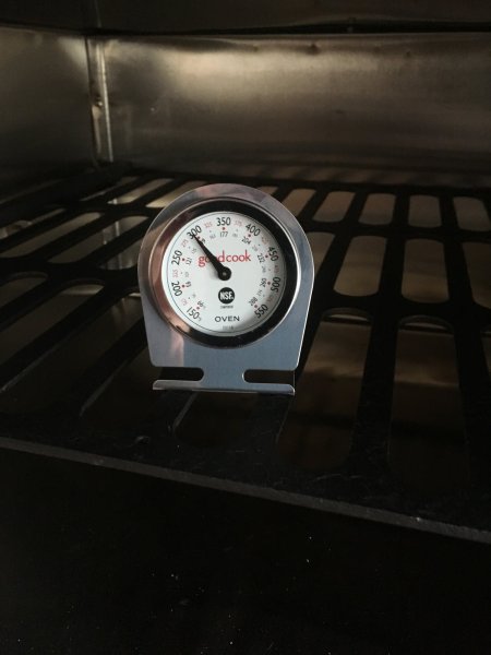

    Got the STT to 600• and oven temp to 300• 8A31F220-AC58-40E3-BAA6-D3929C1437E3.jpeg 6A383D0F-45B9-422C-9375-B86E5D9682F7.jpeg 4ED2151F-9D87-4103-B013-910AF33B53E6.jpeg 4F7042EB-C720-4561-B7AB-0782F70DE547.jpeg

    My stack temp (pipe surface) is currently 250 which is approx. 500 internal, oven 300 without turning it on, stove top lid over firebox 510, stove top surface around lid 480. 68* in the farthest bedroom away, 0*f. outside. Going down to -6, it will creep up inside overnight to 72, then drop back to 66 by morning.

    I appreciate the information. I’ll burn it today using your advice, and see what temperatures I get. It’s all 6” pipe - starts out oval at the base. I do get plenty of draft. I baked some biscuits and found out quick that it’s easy to burn the ones closest to the firebox.
