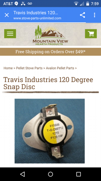

    Last year used a couple times..he said it worked then. The insert came with the house when the guy bought the house. Said he didn't know much about it except it worked, didn't like it. He actually took his whole chimney flue down! Thanks for the blower info.

    This is what it looks like. It has to get to 120° to turn on. Screenshot_2016-12-02-19-59-23.png

    Guess it would be hard to check if not burning. The guy had pulled the insert out, and was in his basement.

    A hairdryer will fix that. Direct the heat of the hairdryer onto the snap disc, and it should turn on.

    Or just jumper the contacts. Obviously don't get zapped, use insulated wire and or rubber gripped pliers.

    Hair dryer or jumper. OK, no worries I'd get someone else to do that testing. I'm a chicken with electrical.

    The Drolet that I just installed in the thread that I linked to earlier was purchased on the cheap at the end of last heating season...I think one reason he hadn't sold it before was that he said the blower didn't work...I suspected that it just had a thermoswitch that needed to be hot, so I drove the 1.5 hours to go look at it, yep, there's the switch, so I took the risk and made the deal. When I got it home I jumped around the switch and the blower was fine. I did wire in a manual switch for it because it takes too long to come on and then goes off too early when relying on the thermoswitch (IMO)
