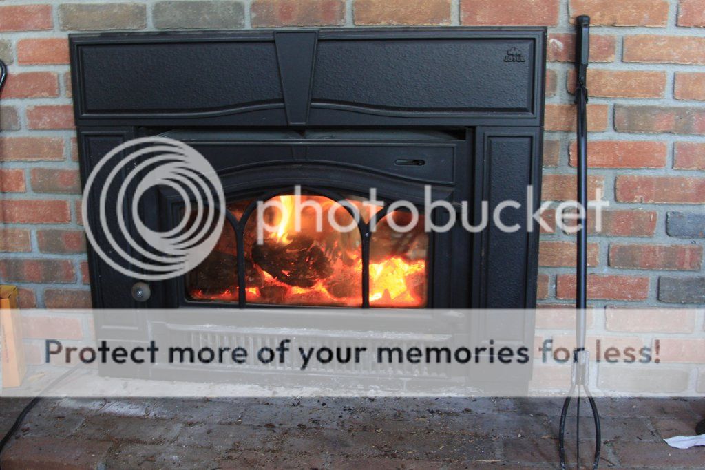

    I had a flush insert, Jotul Rockland c550. Worked well and very nice looking. Right at the limit what would fit in my somewhat small fireplace.
    Flush inserts have a lot of disadvantages though. Maybe some work better than the Rockland but swapping it for the freestanding Woodstock stove was a major improvement.

    Now that's a gorgeous insert! Yes flush do have there disadvantages. I'm tester ingredients back & forth. If I buy the used Lopi it's not flush, but only $300.

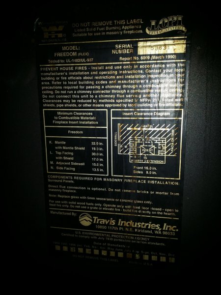

    Well that would be simple. It still did not turn on, though.
    That was a great deal. Freedom model is still available
    Here are the pics I took tonight. Wasn't thinking..should have gotten inside pics too! My new friends here could take a look and offer opinions & advice.

    Yep, that's a big one. Sometimes they have on, or auto, which uses the thermo snap disc. You can always bypass the snap disc to ensure it works. Or use a hairdryer to get the snap disc to turn on.

    Where is the snap disc located? If there was/is one? This insert had a cord with a box switch, & lever.

    The stove is 20 years old, when was the last time it was used? The fan may have seized if it hasn't been used recently. The snap disk is usually in the fan chamber at the bottom of the stove. As the stove warms up it turns the fan on, when the stove cools it will shut the fan.
    I have found replacement fans on the web, either from stove shops (more expensive) or just by eyeballing and picking one from a fan manufacturer (i.e. Fasco). Not usually too expensive or hard to replace...
