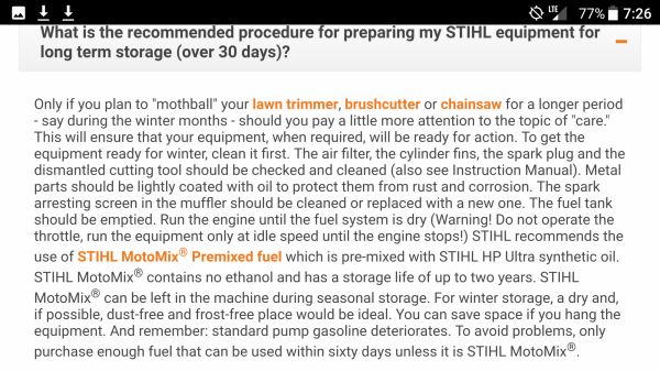

    Seen a ton of crudded up carburetors. Power equipment typically used 1-3 times per year. I'm a run it dry kind of fella. Barring that, I use seafoam and have used the startron? stabilizer in the past. It's not a question of If with egas, but When, in my experience. I will add that non corn gas will also sour eventually.

    Plucked from Stihl's website:

    You could get outboard fogging oil if your planning to put them up for a long time!

    That's for keeping the engine internals from rusting during storage

    Yep. There is very few metals on a saw that would rust externally. Screws maybe?
