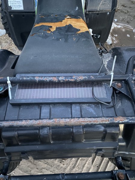

    After replacing the battery 3 times (@
    at least $50 a crack) on my 4wheeler I put one on it. Going on 3 years now same battery. I think I paid $25 for a 2 pack of them at menards. I’m pretty impressed with it

    AC powered or solar? Would love to find something reliable solar powered, although it won't matter if I can get the garage de-cluttered.:rofl: :lol: Like that will happen.:emb:
