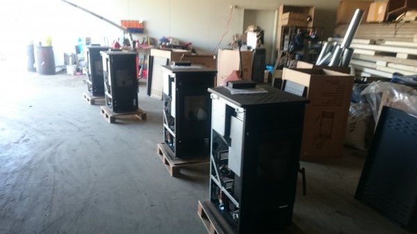

    Orders are starting to trickle in so it is time to get a few stoves modified in advance.
    Here is 4 from this morning. We need to pull out the exhaust motor and put on rubber mounts to cut down on noise. Makes a big difference. We also add more holes to the cast stainless steel burn pot, add side wings and a spreader bar for the wheat. Tape on a choke washer to reduce airflow. Vacuum out pellets, load up wheat, reprogramme the pcb so we have lower set points on the thermocouples, and we are right to go. We will run each stove for a couple of hours to ensure the settings are correct then pack em and ship em...

    The wheat burns to a clinker which needs to be tipped out once or twice daily depending on how hard you run the stove.
    The pits burn to ash and yes more than pellets so the ash pan needs to be tipped out once per day. Messier than wheat as it is so light and fluffy, but like you say, you just deal with it. WE dont get the vent filling up the same but I would say that is more a reflection of the stove design, we have our exhaust low enough so that the fine ash does not go through the stove and stays in the firebox.
    We find the SmartBurn is invaluable in keeping the airways of the stove clear so it keeps running properly. I got howled down on the other site for suggesting this product is anything but snake oil. I do not sell a stove without one as I know it cuts back aftersales calls by heaps. THey last at least a season so it is cheap piece of mind. Others claim burning aluminium cans do the same, well I have tried and it is bull. Running hot all the time will fix it but that kinda defeats the purpose of having a thermostat. Put in a SmartBurn and just run however you like.
    When customers ask what is the best fuel I say for looks; wheat, for value and heat;pits, if money is no object; pellets.
    Once pellets are within $100/ton of the others then pellets are the best. Till then pits for me.
