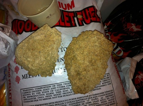

    Had 2 bags on the concrete floor since last spring. Opened them up, and said oops. Spent today putting pallets down, lesson learned!

    damm! Who woulda thought?! Nice stash btw....'Sets, Pennwood's and PTL's I see :D

    Those will burn....... In a wood stove or outside pit fire ;)

    Looks like cornbread...Make some chili and dig in!!:drool:

    Hit em with a hammer until they look like pellets...then burn away :)

    I use dem footballs like eco blocks. Toss em in my wood eater if I happen to make any. I also toss them in the outside fire pit or charcoal grill.

    yea, don't bust em up and put it in the stove....the fines can cause issues such as ratholing and possibly clogging the auger......firepit, woodstove, etc

    Ya it made me laugh when I opened up the bag, it was my fault for sticking them on a concrete floor. My brother in law took the clumped up bag to burn. I like the cornbread idea lol!
