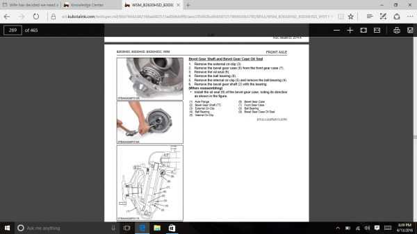

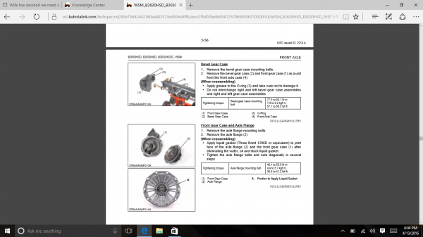

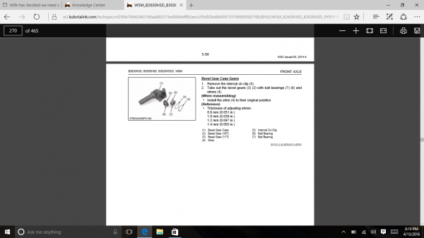

    For your viewing pleasure. For whatever reason I could not get into an L series book. This should be the same.

    Basically, you take the hub all apart, remove the snap ring for the swivel, and drive the swivel out of the bearings.
