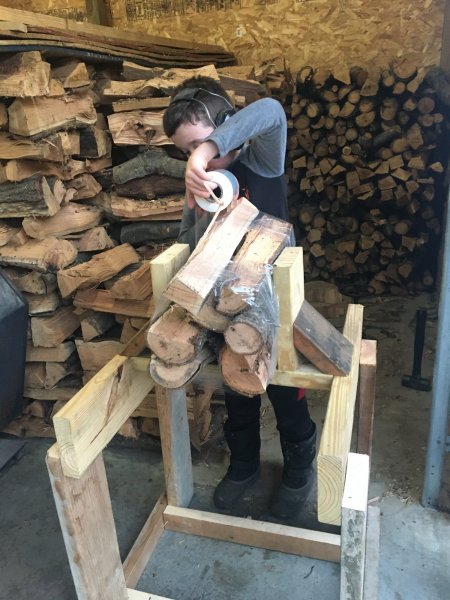

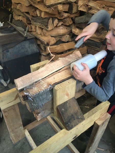

    The boy and I put together a jig for him to build his bundles with. He is able to place the wood across the 2x6 cradle and has enough overhang to wrap the ends of the bundle. Little guy has to strain a little to get it over the side before carrying it to his stack, but he’s able to do the whole process himself. He’s pretty excited and the jig seems to work pretty well! Gonna let him get ahead a little on his stock before we put together a stand for him, but that’s next:yes: 083108E7-092A-402F-9887-98B3FD08E4B4.jpeg F6144DD2-21CC-4341-B063-2D12BC4259CA.jpeg

    Nice way to help him out!

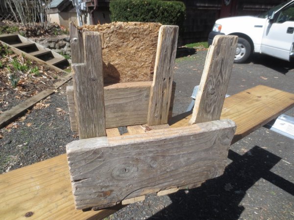

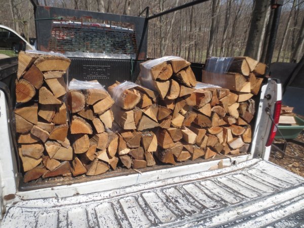

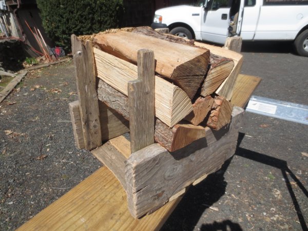

    Here's my bundling jig. Bundles are 9x9x16 .75 cubic ft. I use 12" wrap but will unroll and reroll to precut to 9' pieces inside beforehand. Trying to wrap with a big roll is impossible. The 4" roll your son uses will work too.
    The jig is several years old and has been fixed/modified a few times. Too lazy to make a new one. Most of the time assembled right n the tailboard. I dont put handles on the bundles. IMG_4600.JPG IMG_4601.JPG

    Threat [Great] looking bundles Brad! No need to rebuild if it’s still working For ya. Do you sell bundles or supply bundles for someone else to sell?

    I didnt think they looked that threatening. I wholesale. Ive tried retail with minimal success

    He is really concentrating
