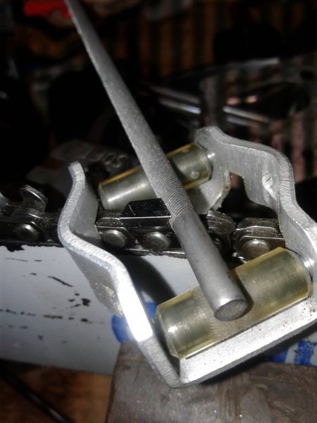

Why is this chain not sharp?

    A maintenance sharpen is nothing but when the chain has been rocked or touched steel it's a whole nother story. I measured the rakers and they are just below the teeth.

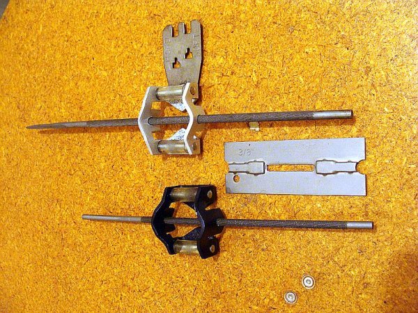

    The part number of the Husqvarna .325 standard guide is 505 69 81-09.
    The part number of the Husqvarna .325 narrow kerf guide is 505 69 81-08.
    Both are natural aluminum in colour.
    The site and my computer don't get along, but give it a try
    Husqvarna Filing equipment Combination gauges

    From my perspective, The teeth are not ground far enough back to eliminate the rolled in corner, the depth gauges look to be untouched which means the tooth can't bite even if properly ground. Minimum .020 top of depth gauge to top of tooth ( I use .030 for the most part.) if using a gauge for this pay attention to where the sides of the gauge are, that they are not contacting some else and giving a false indication. ( when using a bench grinder or similar). some are pretty deep and long and will ride on the vise parts.

    Ok so how many strokes should I attempt to do on each tooth? I did 10 strokes per tooth earlier today and it still didn't cut great. Better but not great. I may have to check the rakers more closely.

    You have to keep filing till you have a crisp working corner, zero damage on the top plate. Then use the raker portion of the guide.
    Great info, that very well could be the issue. What are the odds we could find someone with both pieces to confirm?
    @ this point I would advise NB to lightly file the top of the slot until the 3/16" rides flush in the gullet on the newest chain in your possession, new being ideal. To match my earlier pic.
    I'm personally not a fan of round ground chain. When you get good enough with a file, it's not as fast.

  6. concretegrazer
    concretegrazer
    4,429
    12,456
    Southwest MO
    Here's mine.
    OldJack, HDRock and 94BULLITT like this.

  17. OldJack
    OldJack
    Apr 16, 2014
    311
    1,647
    Saskatchewan, Canada
    The 3/8" low profile guide with raker gauge and the .325 guide, both with the correct sized file. I'm never too sure that the low profile raker gauge is accurate. File Guides.jpg

  20. NBourque
    NBourque
    Jul 12, 2016
    261
    726
    Maine
    No worries man. I filed down the husky roller a hair on each side and it fits good now.
