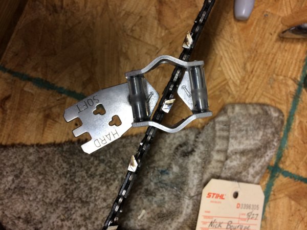

    I read plenty of info online before I bought the husky roller that it would fit a stihl RS chain.
  3. The Wood Wolverine
    19,008
    122,826
    It does. I use it and posted a pic of it on Stihl RS. The silver color denotes it's .325 so I'm fairly certain it's the right one. Gauge I don't think will matter.
    Taller side goes to the back, smaller front. Arrows point to the front.

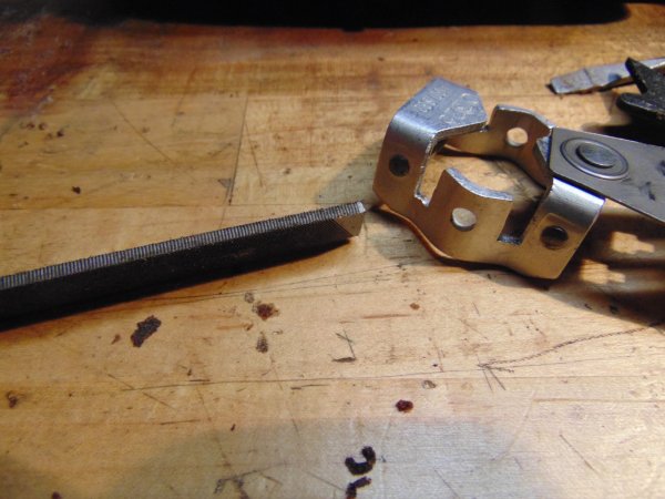

    If it fits super tight, use a flat file in the slot and carefully remove a small amount till it fits better. Sneak up on it so as not to get a sloppy fit.

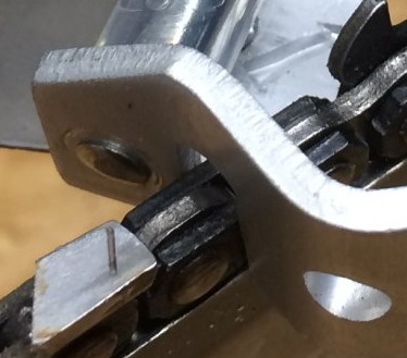

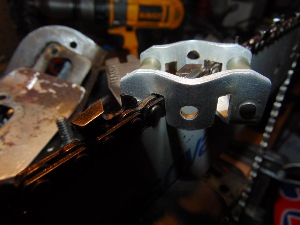

    I don't think you are sitting the whole way down on the chain. I think this is gap:

    That pic sure looks like the guide is not sitting all the way down onto the chain but the slot on the other side of the roller is sitting all the way down on the chain.

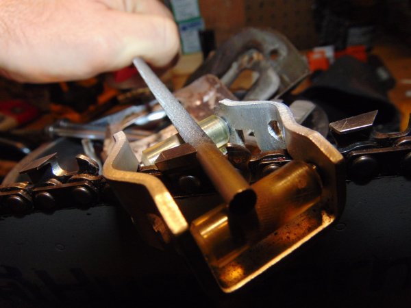

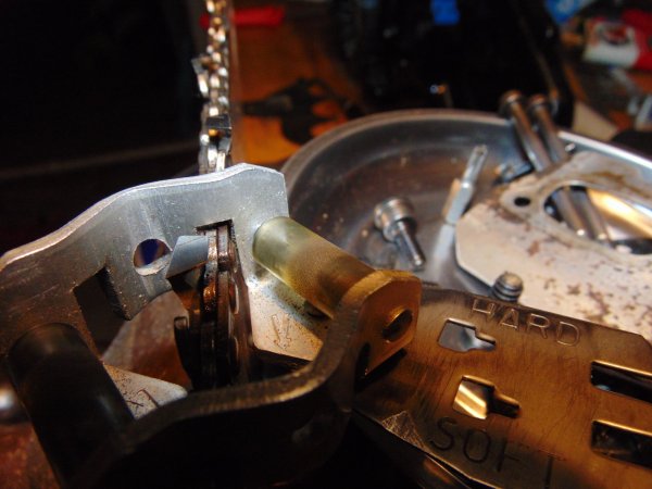

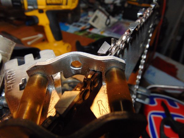

    Got out my good cam
    I am using Stihl RS in .050 so maybe that is the issue. I'd say clearance the guide a little with a flat file to allow it to fit a little easier. I'm guessing it is very tight for you to push down onto the chain (yes?). You could also tweek it to allow it to set deeper (tread lightly).

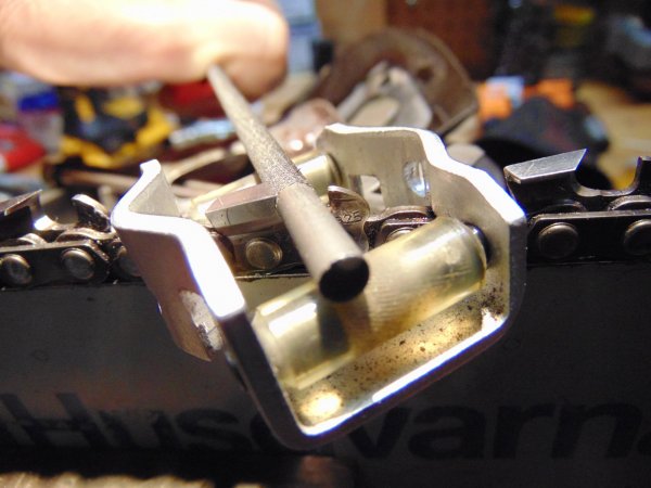

  7. The Wood Wolverine
    19,008
    122,826
    And a small vid to show you I'm not wedging it in there just for pic purposes. And... that's the only time you will ever see me drag a file backwards (I had very little pressure on there) on a tooth.

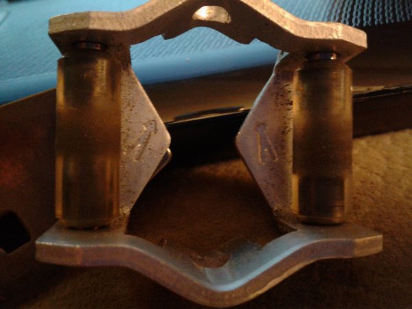

    I think mine needs to be filed a bit so the roller can sit down further on the chain. What do the arrows mean?
  9. The Wood Wolverine
    19,008
    122,826
    They must be pointing to the front of the cutter. It matters which way you mount the guide on the chain.

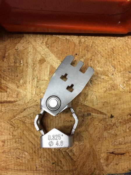

    Got a picture of the back of the jig?
  11. NBourque
    NBourque
    Jul 12, 2016
    261
    726
    Maine
    It's a .325

    I was able to file it down a bit so that the roller fits on the top of the chain like it should now. I was able to make 10 strokes on each tooth considering how bad this chain is. Did some test cuts with it and it cuts better than it did but it's still not as sharp outta the box...

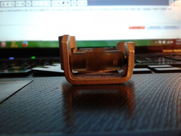

  17. NBourque
    NBourque
    Jul 12, 2016
    261
    726
    Maine
    Here's mine
