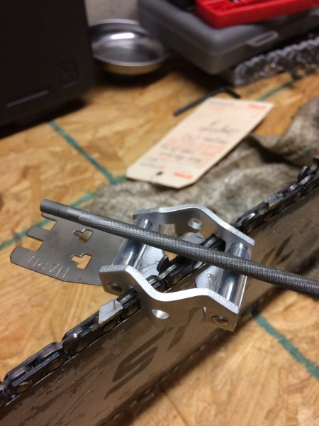

    So I just received the .325 husky roller file guide and it rides too high on my stihl RS chain. Any ideas?

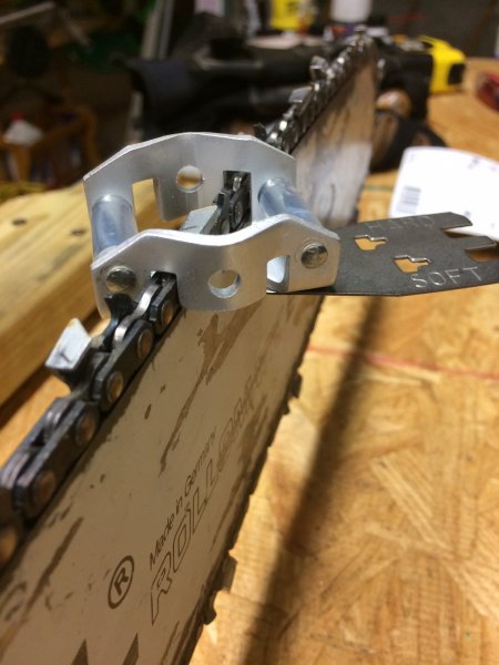

    Can you post pics of how you have it sitting on the chain? Here's mine on Stihl RS.
    If you zoom in, you can see it's Stihl chain.
    brenndatomu likes this.
  10. The Wood Wolverine
    18,921
    122,021
    Hard to get this phone to focus where I want it and hold the file in there.
    The guide does have a front and back. The taller end should be back and make sure it's all the way down. IF you want it lower, you could file the slot a little. I've never done it (haven't needed to).

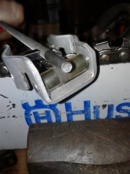

    U can see the file is not inside the tooth.

    Is the guide marked .325 or does it have a part number on it? I'm thinking it could be for 3/8LP.

    Could be wrong . But I believe you have it on backwards . Note the arrows below the rollers .

    It's marked .325
  18. NBourque
    NBourque
    Jul 12, 2016
    261
    726
    Maine
    Either way I put it on the file does not fit inside the tooth
  19. brenndatomu
    25,261
    164,380
    Sounds like either the chain is not the size you thought it was? Or the file is not the size it is supposed to be...
