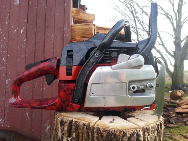

    Why is porting necessary? That's easy........................:loco: :crazy:
    Gives people more time to polish, dress up, and whisper sweet nuttins. :D

    :drool::drool::drool:... That's a beautiful saw... Love the skulls...:yes:

    your bar is missing....or is this a shelf queen???:rofl: :lol:
