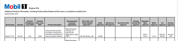

    I actually run Mobil 1 0w40 euro spec stuff in all my small engines as well as my LSX powered cars and ATV. I change all often, as I don't drive the cars much. I run HPL's oil in our daily drivers. If you watch enough of LSJr's videos, he visits HPL's lab when he does some of his testing. They are in N IL.

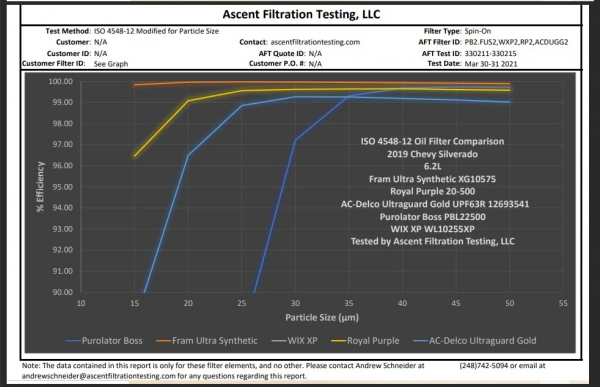

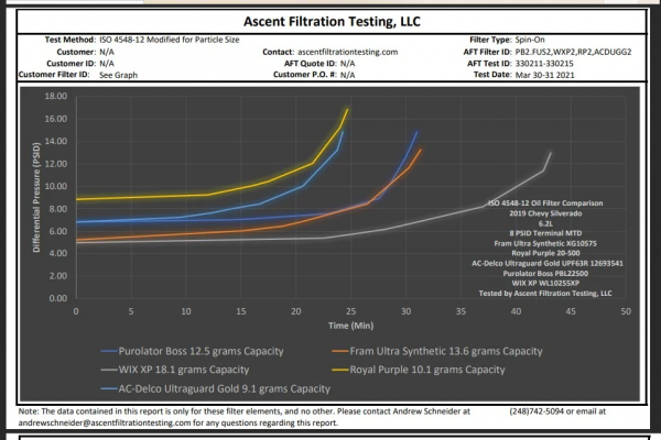

    Same here. I bought a handful of cases of Fram Titanium's (Fram Ultra's) back before they cheapened them up. Back then they tested out with very high efficiency and lower pressure drop through the media and decent capacity. Best of both worlds. No idea how they would test out now. Wix XP is a long drain interval filter and is NOT efficient at all, but it does have ton's of capacity. I actually run the same 10575 oil filter that was tested on both of our daily drivers.
    https://bobistheoilguy.com/forums/t...e-point-and-burst.334882/page-19#post-5789087

    Isn't the euro spec oil diesel and gasoline rated?

    No, I believe they are only gas certified.
    No JASO rating needed for my ATV. :D

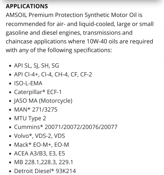

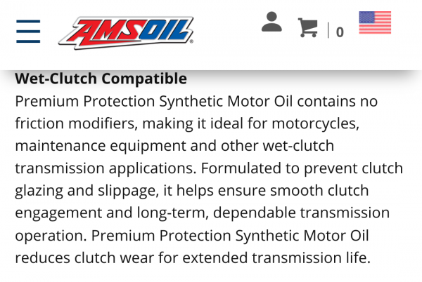

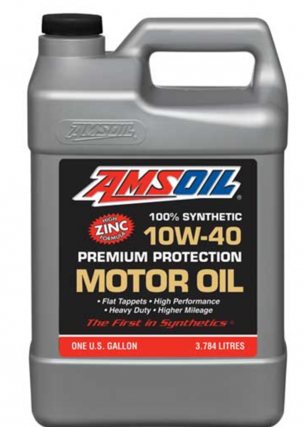

    This is what I have been using for several years in my pre emissions diesel Kubota and all 4 stroke ope.
    Screenshot_20250624-152734~2.png Screenshot_20250624-152814~2.png Screenshot_20250624-152802~2.png

    Correct, no wet clutches, right?
