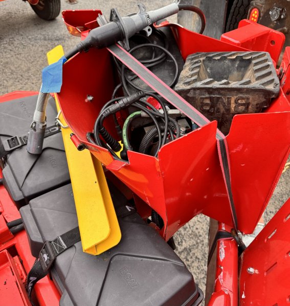

    IMG_5468.jpeg More things that go bump in the night.
  13. Woodtroll
    Woodtroll
    Jan 10, 2025
    594
    4,596
    Mtns of SW VA
    What did it used to be? A tractor or implement tool box?
  14. Warner
    Warner
    Jun 19, 2017
    7,368
    47,703
    Hydraulic pump/box for an asphalt hot box.

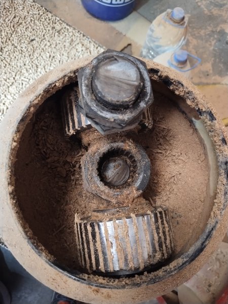

    30 mm threaded shaft on our pellet mill decided to snap today. This thing has been a joke since we bought it new. I've put over 40 bearings in the dies drive wheels. Factory says that we are the only person with any issues. Factory said to torque the nut on the shaft to two fingers tight from a 150 pound man. I asked him to get that in writing. Nut is only torqued to 14 - 17 ft. Lbs.
  16. Haftacut
    Haftacut
    Apr 1, 2020
    2,985
    17,441
    Rives Junction, MI
    Sounds beyond frustrating!
  17. brenndatomu
    25,308
    164,757
    The way that break tapers to a point in the middle, looks to me like the shaft was bent...that would explain eating all those bearings too.
  18. Screwloose
    Screwloose
    Jan 15, 2017
    5,685
    33,740
    The reason it broke is quite fundamental. You cannot use imperial torques on metric threads.
  19. brenndatomu
    25,308
    164,757
    So how many kilograms does 150lb man equal? :rofl: :lol:
