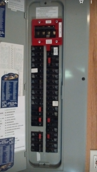

    The circuits That will be on the transfer switch are
    furnace
    well pump (120v) (and water treatment ....... same circuit IIRC)
    fridge outlet
    freezer outlet
    some lights/some outlets
    water heater ..... this will be turned off and on manually on a as needed basis during extended outages
    There is no way to isolate the garage door openers as the garage is on a sub panel from the house....but there is nothing drawing elec from the garage until we use the opener or lights or.... gonna have to look at that a little closer when the time comes.
    I think the entire house was wired with 12/2 so there are no 15 amp circuits. Many of the manual transfer switches have 15 amp circuits in them so I'll have to dig a bit deeper than what I did so far.
